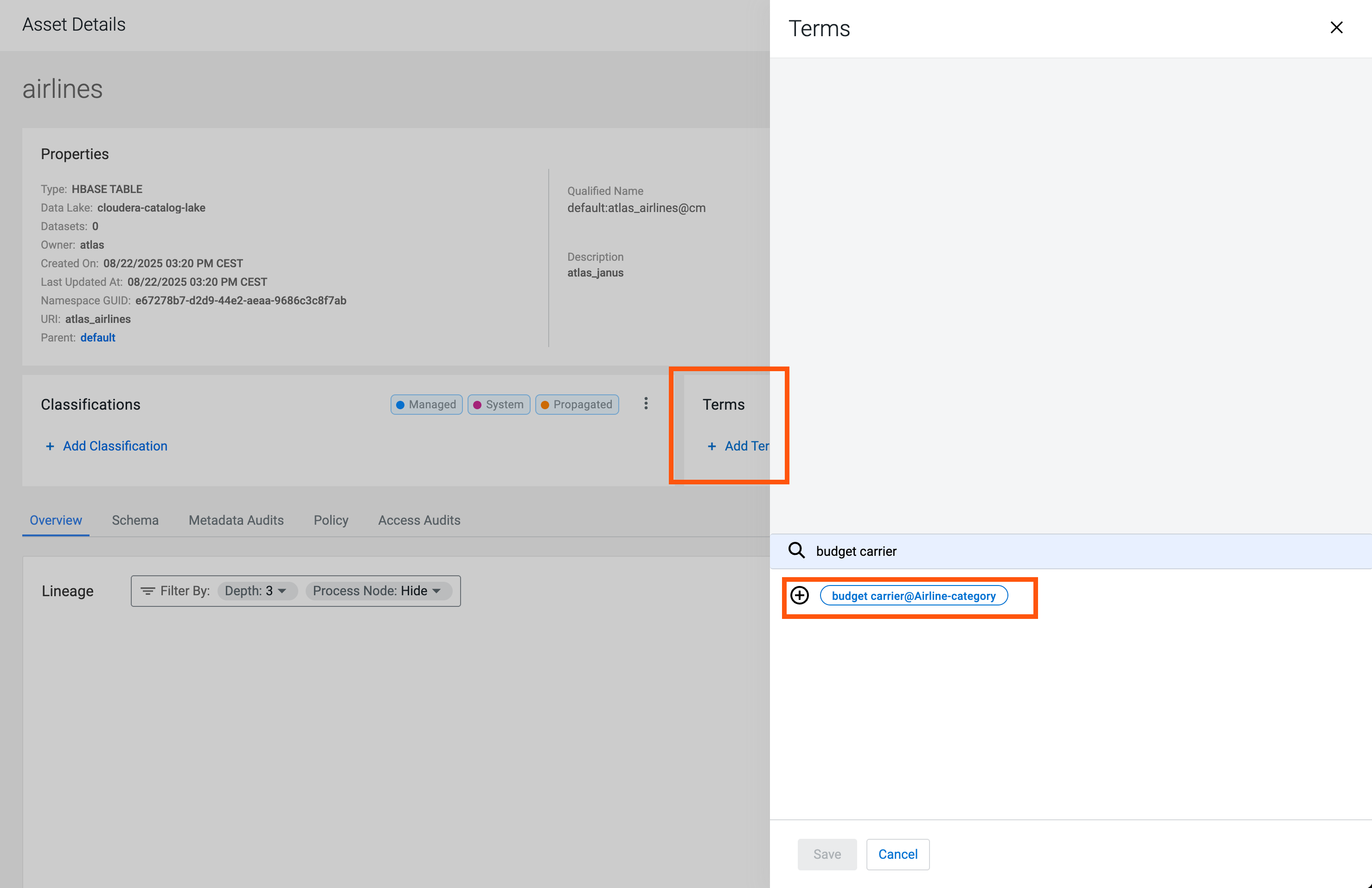

You can use the icon in the Terms widget on the Asset Details page to add new terms for your assets. Click Save to save the changes.
Figure 3. Mapping terms in Asset Details

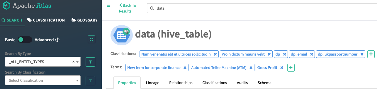

You can search for the same asset in the corresponding Atlas environment as shown in the example image.

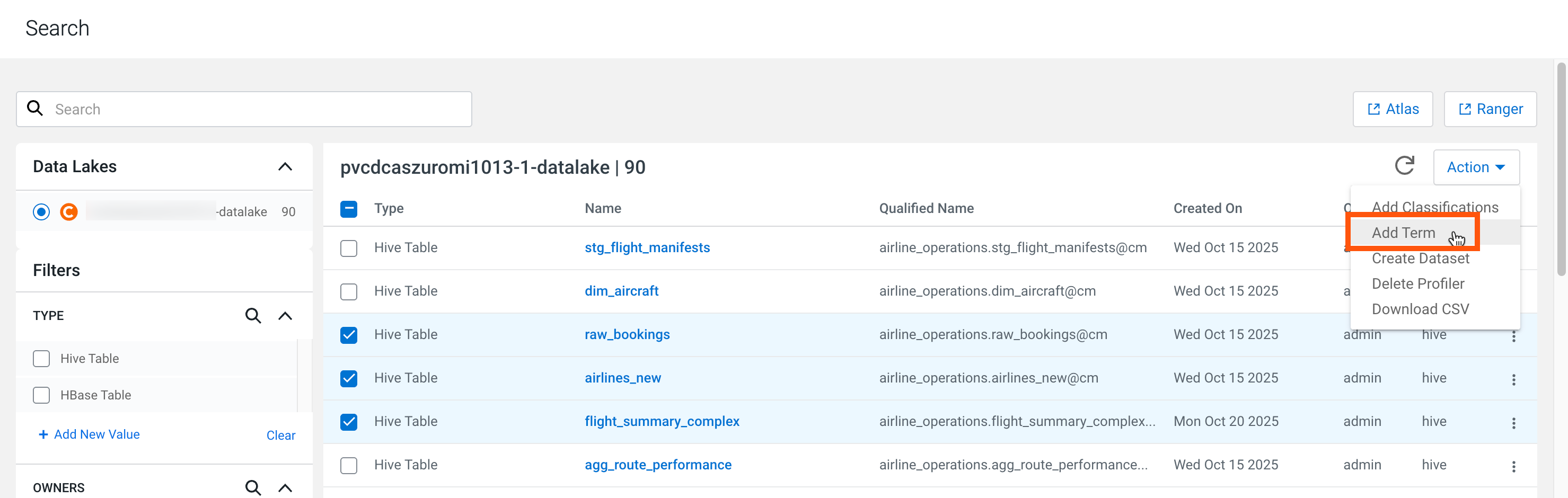

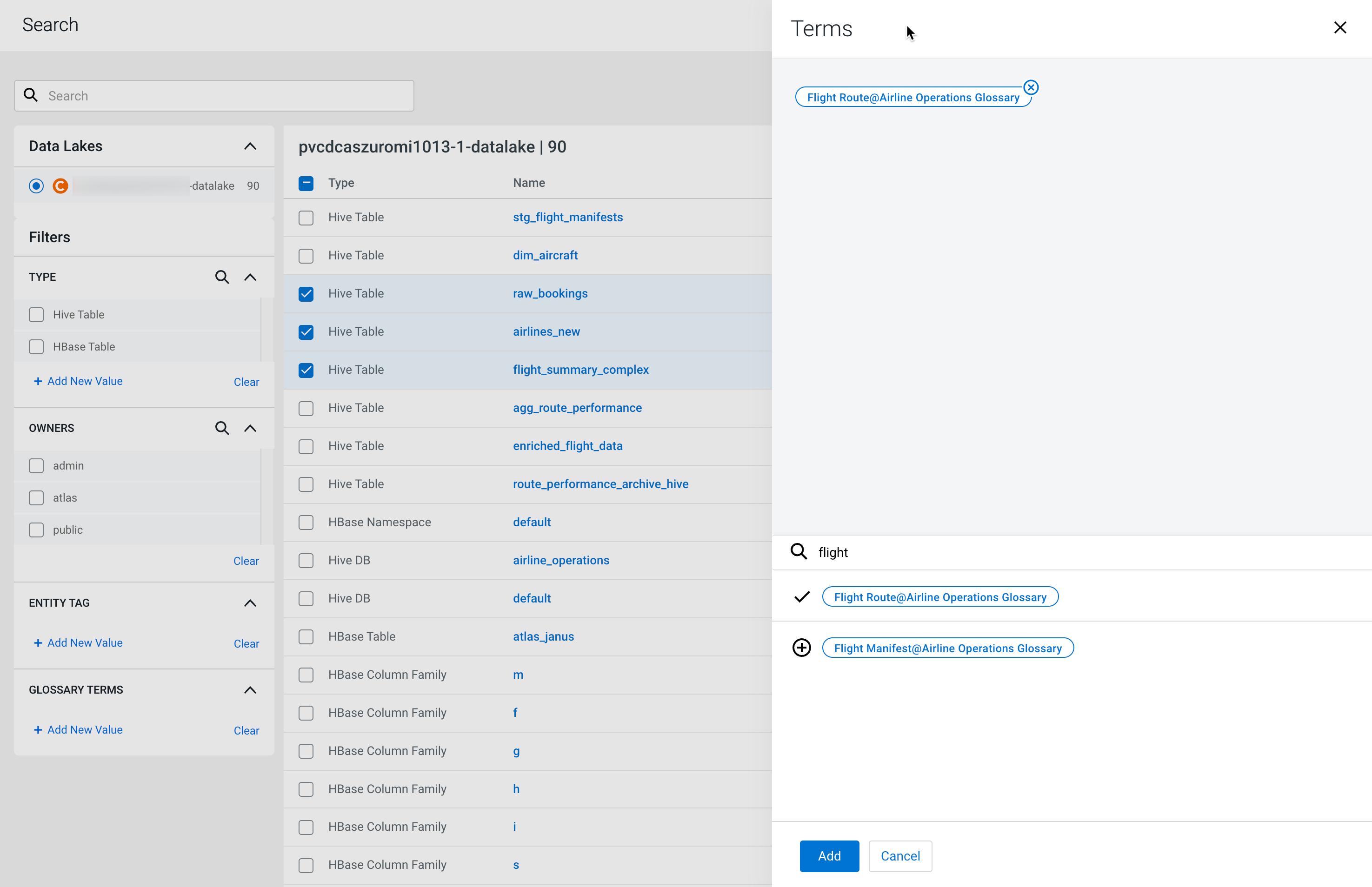

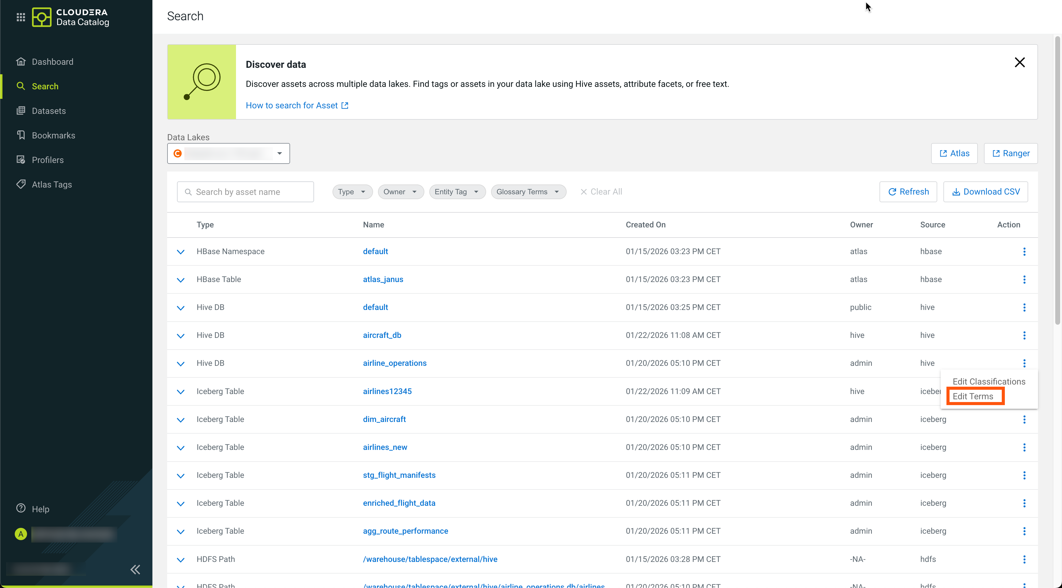

Additionally, you can also associate terms to your datasets by selecting one or more assets on the Search page. You can associate terms with multiple datasets at a time.

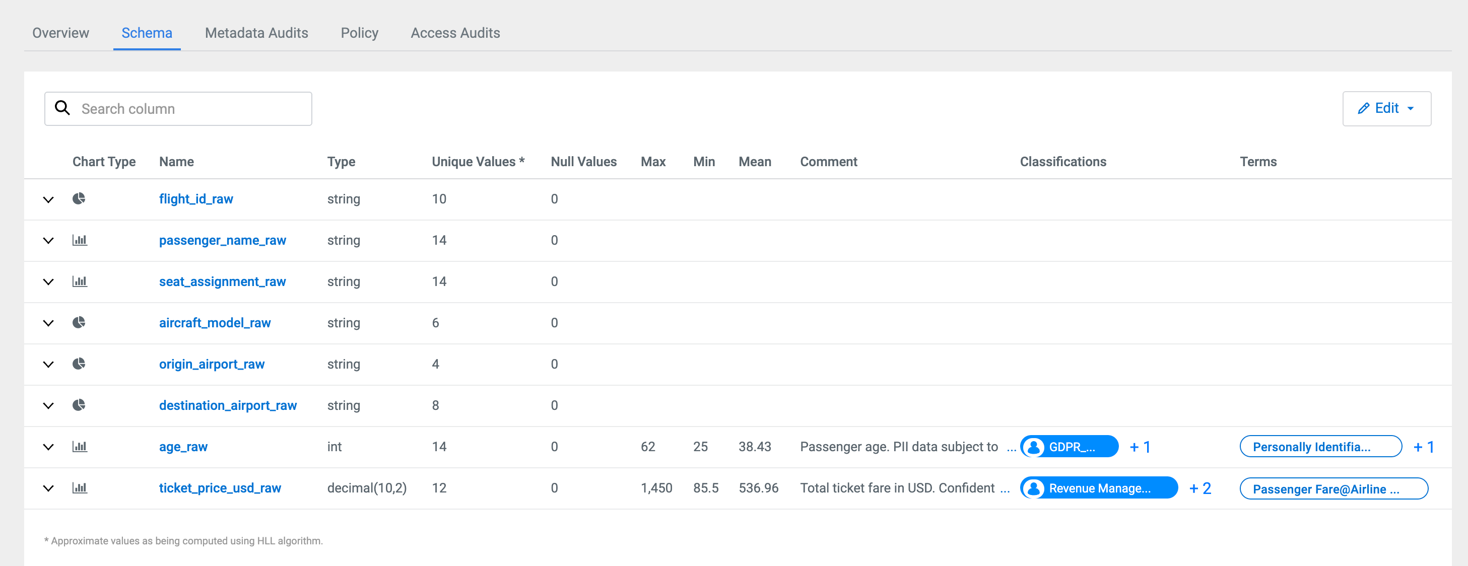

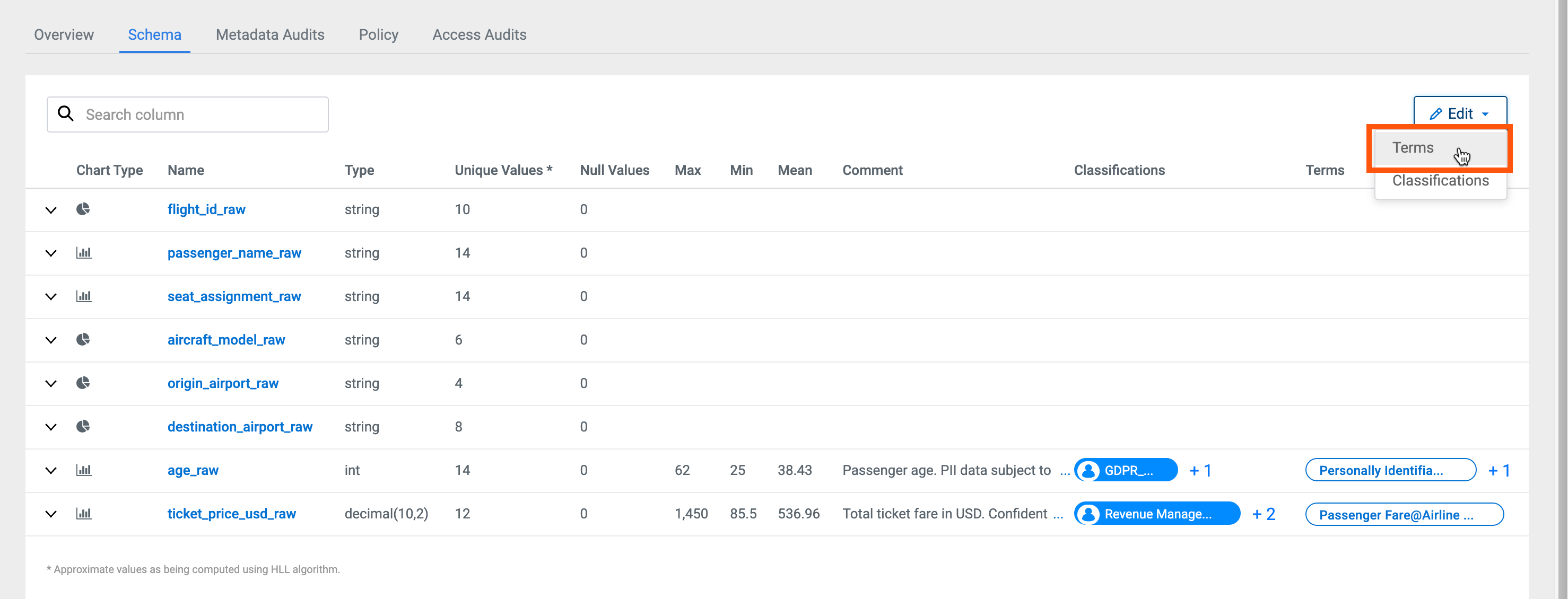

When you select a Hive table asset and navigate to the Asset Details page, under the Schema tab, you can view the list of terms associated with the asset.
You can add or update the terms for the associated datasets by clicking the Edit button.
