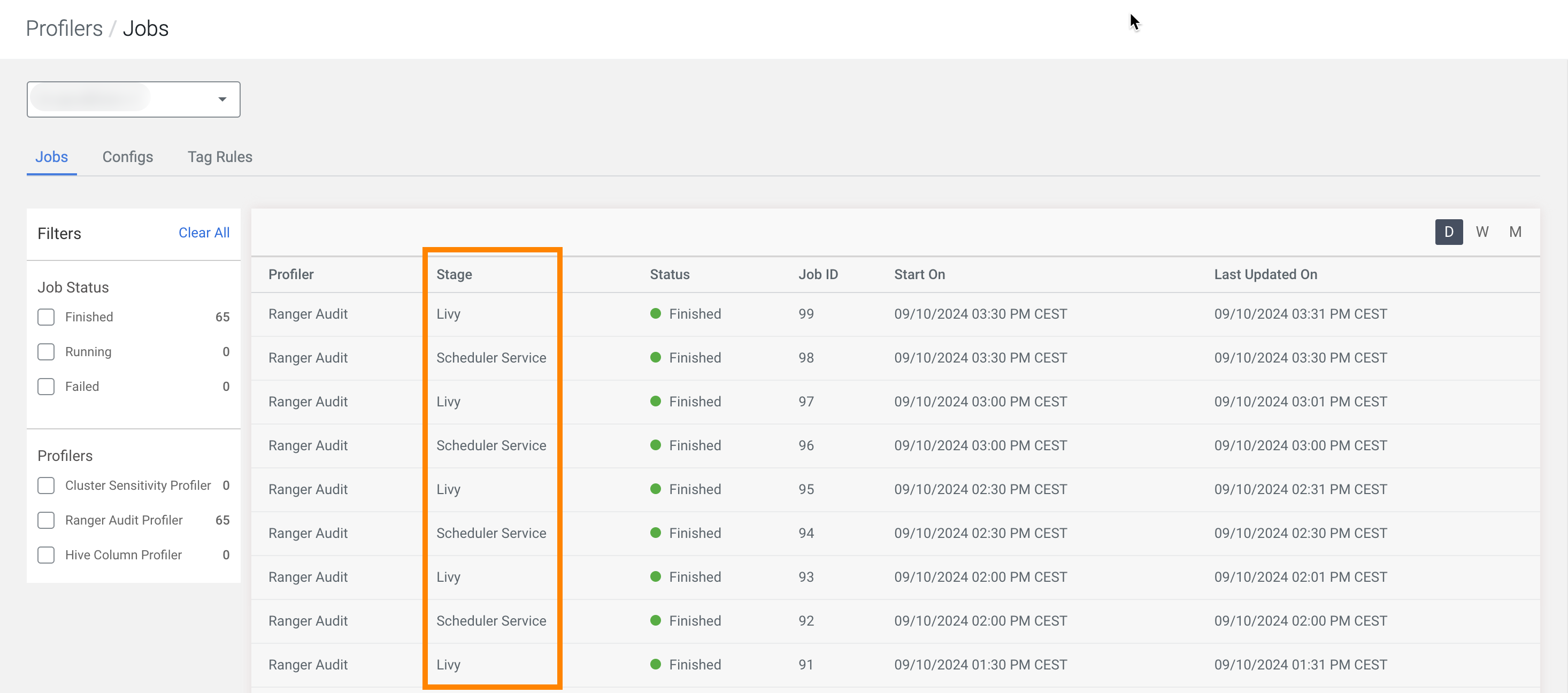

In VM-based environments, Profilers > Jobs can show you the current profiling Stage based on the relevant service used:
Figure 1. Profiling jobs in a VM-based environment
For each profiler job, you can view the details about:
  • Profiler type
  • Profiler Status
  • Stage (for VM-based environments)
  • Job Status
  • Job ID
  • Start Time
  • Last Updated On
Using this data can help you to troubleshoot failed jobs or even understand how the assets were profiled and other pertinent information that can help you to manage your profiled assets.
Click >Details to gain more information about your profiler jobs in Profilers > Profilers Details.
