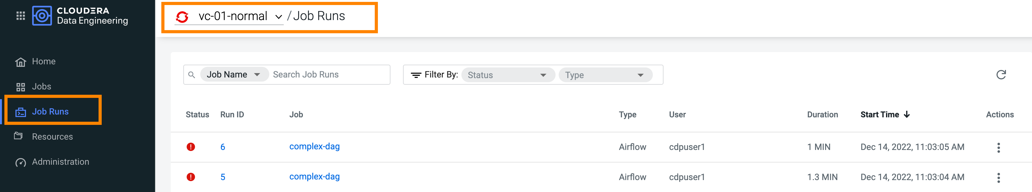

In the Cloudera console, click the
Data Engineering tile. The Cloudera Data EngineeringHome page displays.
Click Job Runs on the left navigation menu.
Using the dropdown menu, select the virtual cluster containing the application
you want to manage.
Click on the job that you want to modify.
