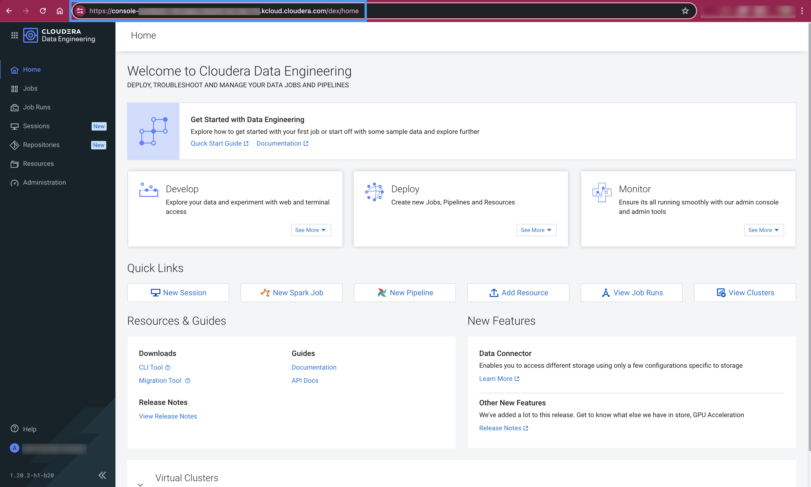

                Generate certificate for the Cloudera domain.
                        Get the domain information from the Cloudera Data Engineering landing page URL.
                        Run the following command using the URL obtained from the preceding
                            step:
                        openssl s_client -showcerts -servername [***Cloudera Data Engineering LANDING PAGE URL***] -connect [***Cloudera Data Engineering LANDING PAGE URL***]:443 </dev/null
- Copy both the certificates from the logs of the command in the preceding step.
- Paste the certificates one after the other with a line space between them and save the file as cdp.pem.

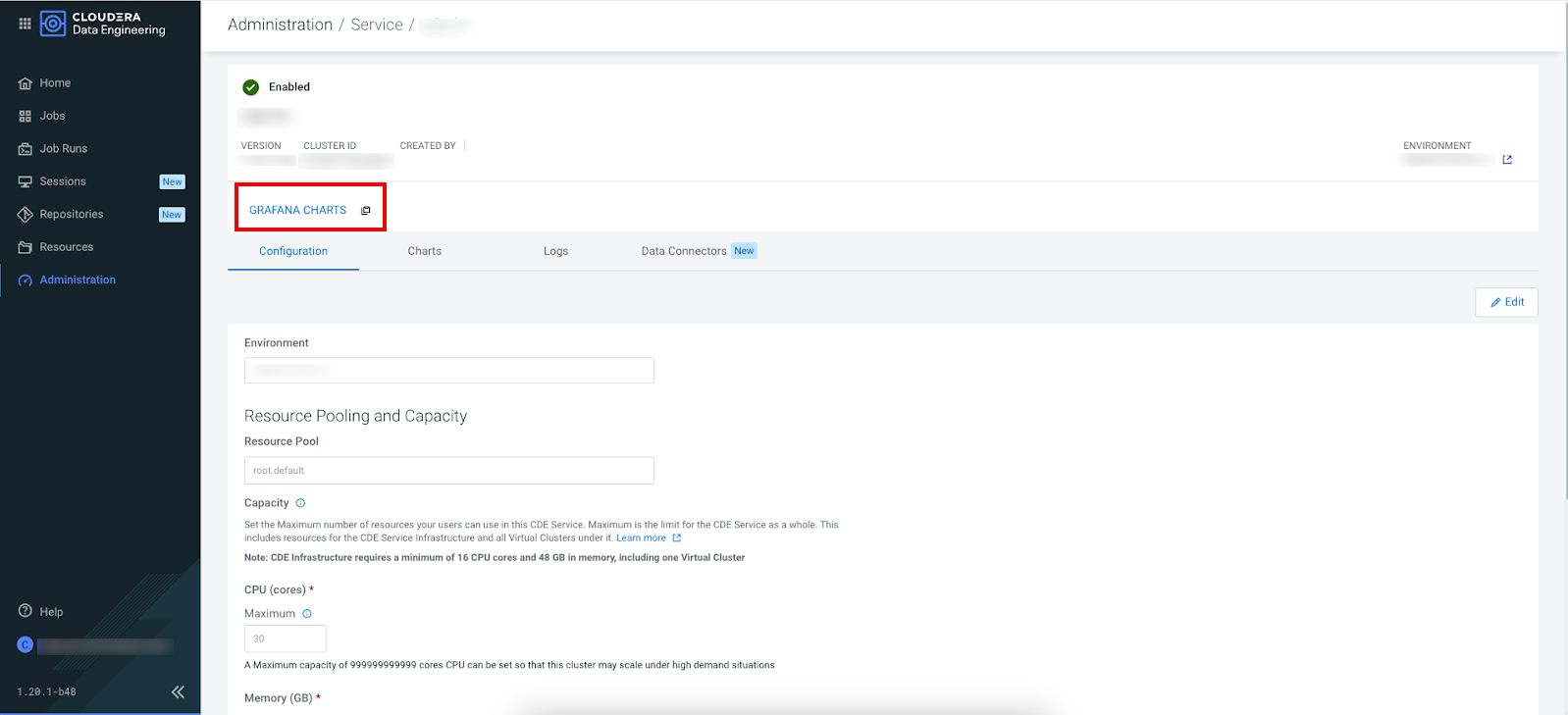

                Generate certificate for the Cloudera Data Engineering domain.
                        Go to the cluster details page in Cloudera Data Engineering and copy the URL of the Grafana
                            charts.
                         The URL of the Grafana charts looks like https://[***GRAFANA CHARTS DOMAIN***]/grafana/d/sK1XDusZz/kubernetes. Copy the Grafana charts domain from that URL. The URL of the Grafana charts looks like https://[***GRAFANA CHARTS DOMAIN***]/grafana/d/sK1XDusZz/kubernetes. Copy the Grafana charts domain from that URL.
                        Run the following command using the Grafana charts domain obtained from
                            the preceding step:
                        openssl s_client -showcerts -servername [***GRAFANA CHARTS DOMAIN***] -connect [***GRAFANA CHARTS DOMAIN***]:443 </dev/null
- Paste the certificates one after the other with a line space between them and save the file as cde.pem.
                            charts.

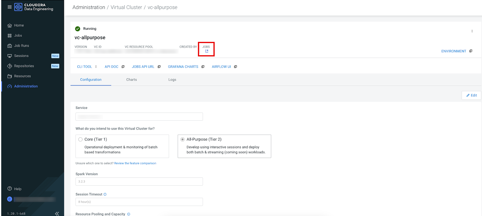

                Generate certificates for the virtual cluster domain.
                        Go to the virtual cluster details page and click
                                Jobs.
                         The Jobs URL looks like https://[***VIRTUAL CLUSTER DOMAIN***]/dex/ui/. Copy the [***VIRTUAL CLUSTER DOMAIN***] from that URL. The Jobs URL looks like https://[***VIRTUAL CLUSTER DOMAIN***]/dex/ui/. Copy the [***VIRTUAL CLUSTER DOMAIN***] from that URL.
                        Run the following command using the Virtual Cluster domain obtained
                            from the preceding step:
                        openssl s_client -showcerts -servername [***VIRTUAL CLUSTER DOMAIN***] -connect [***VIRTUAL CLUSTER DOMAIN***]:443 </dev/null
- Paste the certificates one after the other with a line space between them in the vc.pem file and save the file.
                                Jobs.
