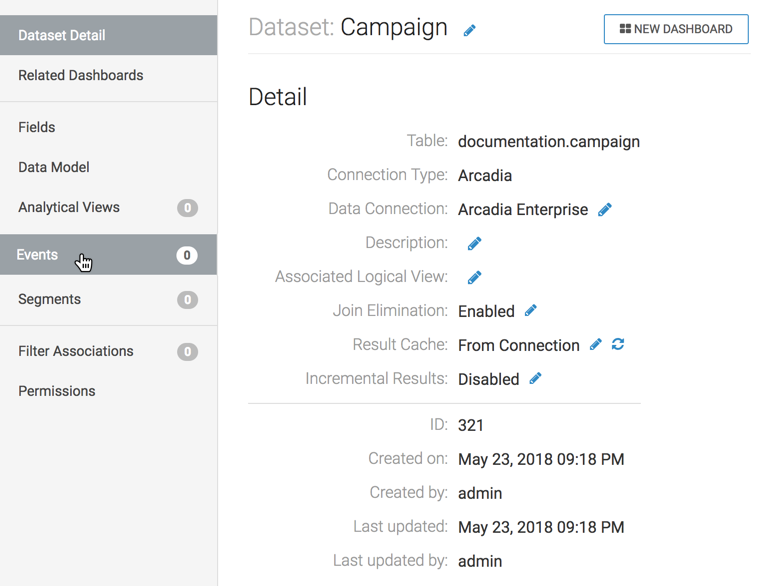

        On the main navigation bar, click DATA.
        The Data view appears open on the Datasets tab.
        Find the dataset in the list of datasets, either by scrolling or by using search, click
          on it, and select the Campaign dataset.
        Dataset side navigation appears open at Dataset Detail view.

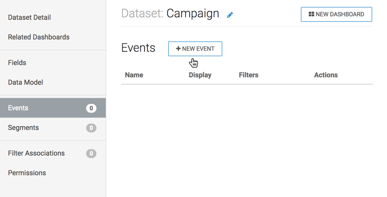

        In the side navigation menu, click Events.
        The Events interface appears.

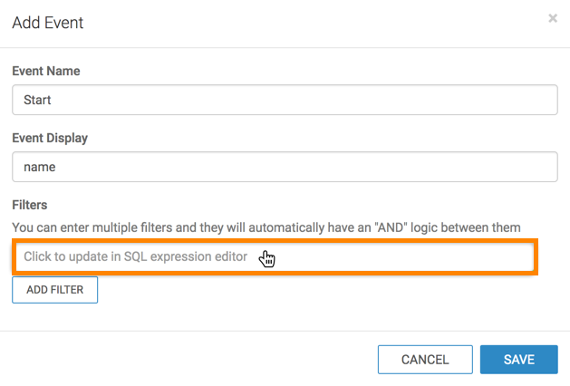

        In the Events interface, click New
          Event.

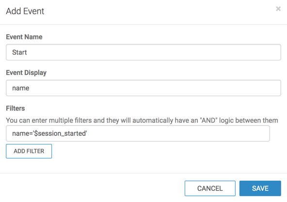

        The Add Event modal window appears.
        In the Add Event modal window, add the following:
- Under Event Name, enter Start.
 - Under Event Display, enter name.

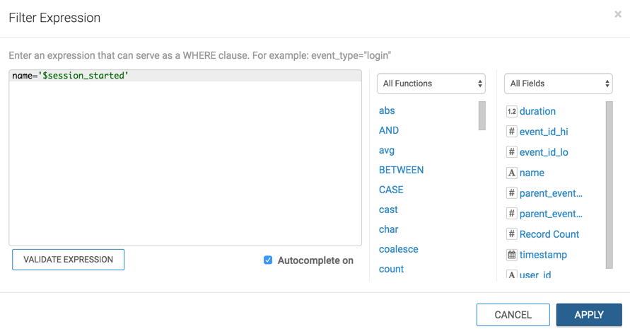

Under Filters, click the text box to open the Filter Expression modal window.
        In the The Filter Expression modal window, enter the following
          expression:
name='$session_started'
        Click APPLY to save the filter expression and return to the
            Add Event modal window.
In the Add Event window modal, you can see that the Filters field contains the specified expression.

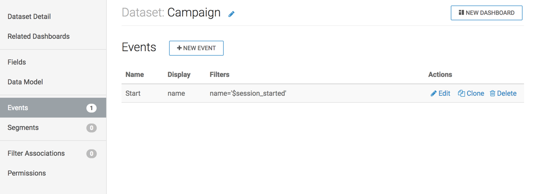

        Click SAVE.
          The new event definition appears in the Events interface. The following actions are available for this event: Edit, Clone, and Delete.

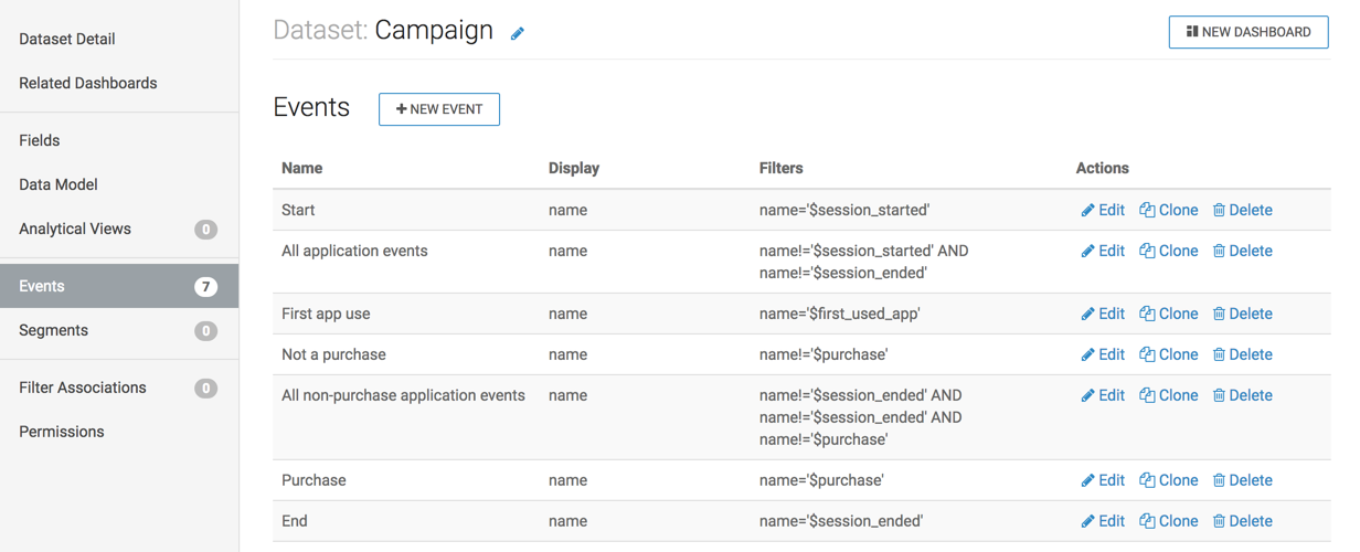

        Repeat the preceding steps to create six additional events for this dataset, as defined
          in the following table.
You already created the event in the first row. Alternatively, you can create new events by cloning existing events. For more information, see Cloning Events.
Table 1. Events of the Campaign dataset Event Name Event Display Filters Start name name='$session_started'All application events name name!='$session_started'ANDname!='$session_ended'First app use name name='$first_used_app'Not a purchase name name!='$purchase'All non-purchase application events name name!='$session_started'name!='$session_ended'name!='$purchase'Purchase name name='$purchase'End name name='$session_ended'When you finish defining all events for the dataset, your list of events should look similar to the following:
