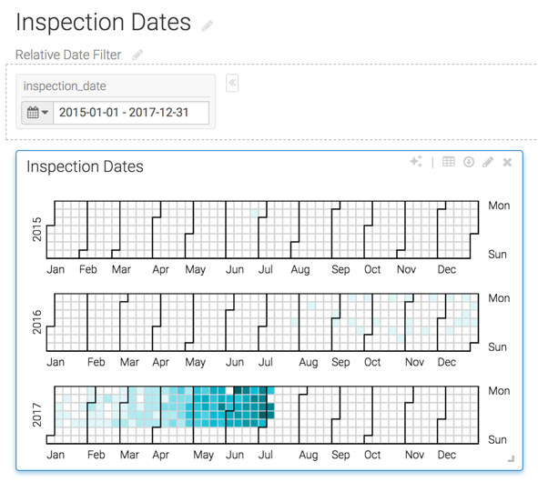

    This adds a filter to the dashboard. This filter is based directly on the inspection_date field, and has a timestamp type.
    The dashboard filter contains the date range for the entire dataset. In this case, it is for three years from 20015-01-01 through 2017-12-31.

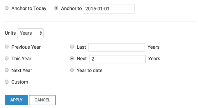

  4. Cick the Calendar icon on the filter and select Relative Dates from the menu.
    The Relative Date modal window appears.
  5. Anchor the date to 2015-01-01 and limit the visual output to the next two years from this date:
    • Select Anchor to and click in the date field to select 2015-01-01 from the calendar interface.
    • The other option is Anchor to Today (default).
  6. Under Units, select Years.
    The other options are:
    • Days
    • Weeks
    • Months
    • Quarters
  7. Select Next and enter '2' in the field next to it.
    • Previous Year
    • This Year
    • Next Year
    • Custom
    • Last <number> Years
    • Next <number> Years
    • Year to date
  8. Click APPLY.
The visual output is now limited to two years, starting from the anchor year of 2015 and the application filter shows the new date range of 2015-01-01 - 2016-12-31.
