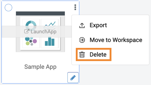

  3. Click Delete.
    You can also use the Suppmental menu of the app tile and select Delete from there.
    The Delete Visual Artifacts modal appears.
    In this example, the Sample App is selected.
  4. Type DELETE in the text box to confirm the action and click Delete.
