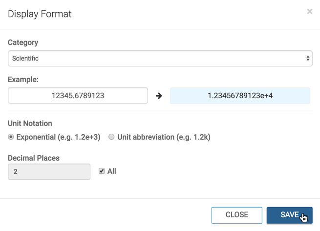

- Click the field you plan to modify, to open the Field Properties menu.
- Under Field Properties, click Display Format.
- In the Display Format interface, select Scientific from the Category menu.
- Make adjustments as needed:
- Under Unit Notation, select either Exponential or Unit abbreviation.
- Under Decimal Places, change the number of decimals.
- To show no decimals, clear the Decimal Places text box.
- To show all decimals, select the All option.
- Click Save.
- Click Refresh Visual.

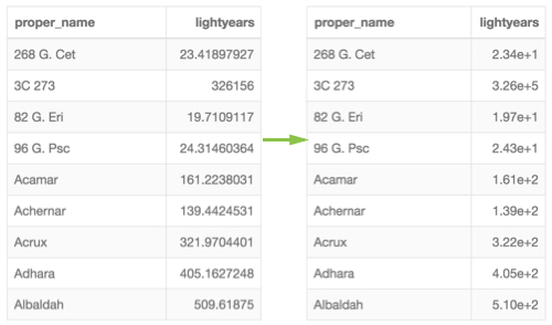

Scientific format with exponential notation
We are using the Encyclopedia of Starsdataset, based on a datafile.
- Create a new table visual on the dataset.
- Place the field
proper_nameon the Dimensions shelf, and the fieldlightyearson the Measures shelf. - Change the Format Display for
lightyearsto Scientific. - Under Unit Notation, select Exponential, and click Save.
Notice the change to the number format in column lightyears.
