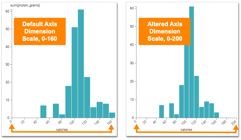

To change the minimum and maximum scale of a continuous axis on dimensions, navigate to the Axes menu, and make adjustments to the two selectors: Min Dim Scale and Max Dim Scale options.
The image on the left shows the minimum and maximum scale of the X axis from 50 to 160. You can see that that in the right image, the scale changes when you change the values from 0 to 200. Increasing the scale also gives a clearer visual representation of where the calorie levels fall within a range of values.
Figure 1. Example: Minimum and Maximum Values of Continuous Axis on Dimensions
