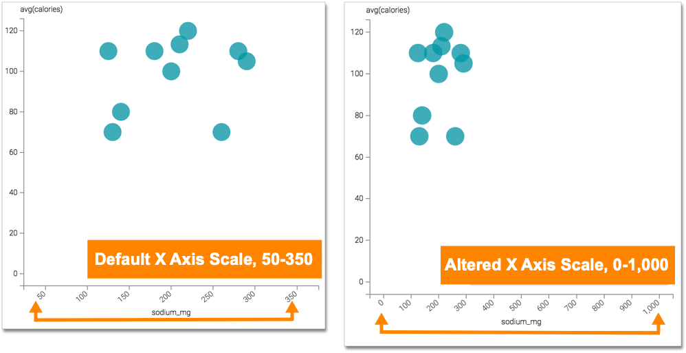

To change the minimum and maximum scale of a continuous X-axis, navigate to the Axes menu, and make adjustments to the two selectors for the Min X Scale and Max X Scaleoptions.
The image on the left shows the minimum and maximum scale of the X axis from 50 to 350. Notice that in the right image the scale changes when we changed the values from 0 to 1000. Increasing the scale also gives a clearer visual representation of where the sodium levels fall within a range of values.
Figure 1. Minimum and Maximum Values of a Continuous X Axis
