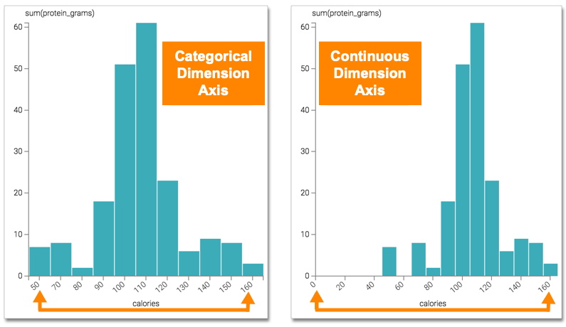

The image on the left shows a categorical X axis where each label represents a value in the
dataset, from 50 to 160. The image on the right shows a
continuous X axis where labels are auto-generated, in equal intervals starting from
0 to 160. Notice how enabling this feature gives a clearer
visual representation of where the calorie levels fall within a range of values.
