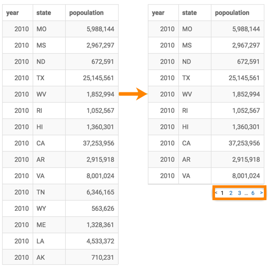

Pagination, with 10 rows per page
In this example, pagination is turned on, and the number of rows per page is set to 10. The table shortens, and an interactive page selector appears at the bottom right corner of the visual.

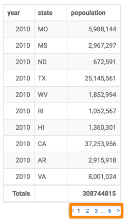

Pagination and totals
If you select both the pagination and totals options, the table reports the same total on each page, and that is the overall total.
