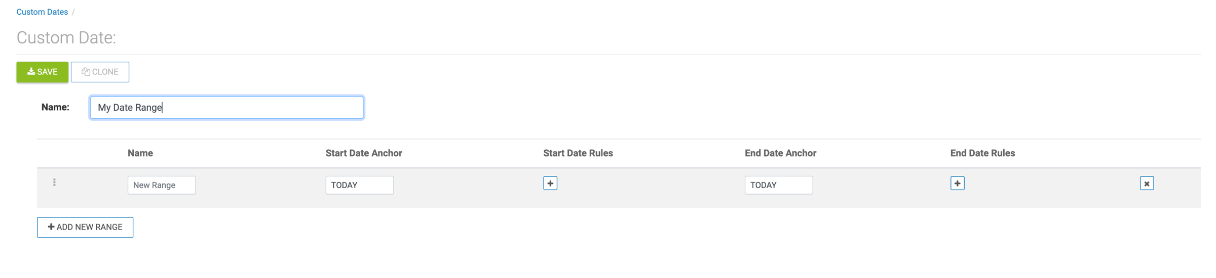

           - In the Manage Custom Dateranges interface, click NEW CUSTOM DATERANGE.

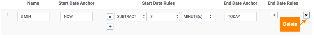

        In the Custom Date interface, enter the
            Name of the custom date.
In this example, My Date Range is used.
        In the list of ranges, define the first range:
- Enter the Name of the new range.
            Under Start Date Anchor, select one of the options:
- Anchor to Today (default)
 - Anchor to Now
 - Anchor to Date, which is the current date by default. To specify an alternate date, click in the edit field and select from the calendar interface.
 - Anchor to Time, which is the current timestamp by default. To specify an alternate timestamp, click in the edit field and select from the calendar and time interface.
Click APPLY.

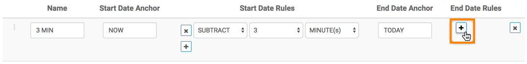

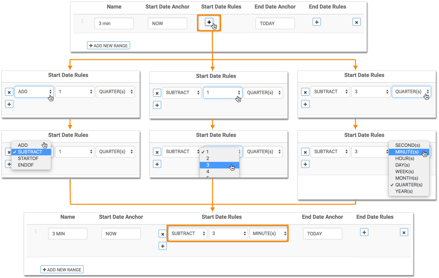

            Under Start Date Rules, click the
                Plus icon and proceed to specify the first stat date
              rule:
Click the text box with operations (Add) and select the operation for the date rule:
Add (default), Subtract, Startof, or Endof.
Click the text box with numbers, and select the appropriate time offset.
Click the text box with units, and select one of the time units from the menu:
Seconds, Minutes, Hours, Days, Weeks, Months, Years, or Quarters (default). We selected Minutes.
This completes the specification of the first start date rule.

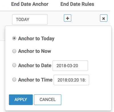

            Under End Date Anchor, select one of the options:
 - Anchor to Now
This works just like the Start Date Anchor.
              Click APPLY.
            Under End Date Rules, click the Plus
              icon.
              Proceed to specify the first rule:
Click the text box with operations (Add), and select the operation for the date rule:
This completes the specification of the first end date rule.
To delete or remove a rule, click the Delete icon beside the rule.
            To remove the entire date range, click Remove icon at the
              end of the row that specifies the date range.

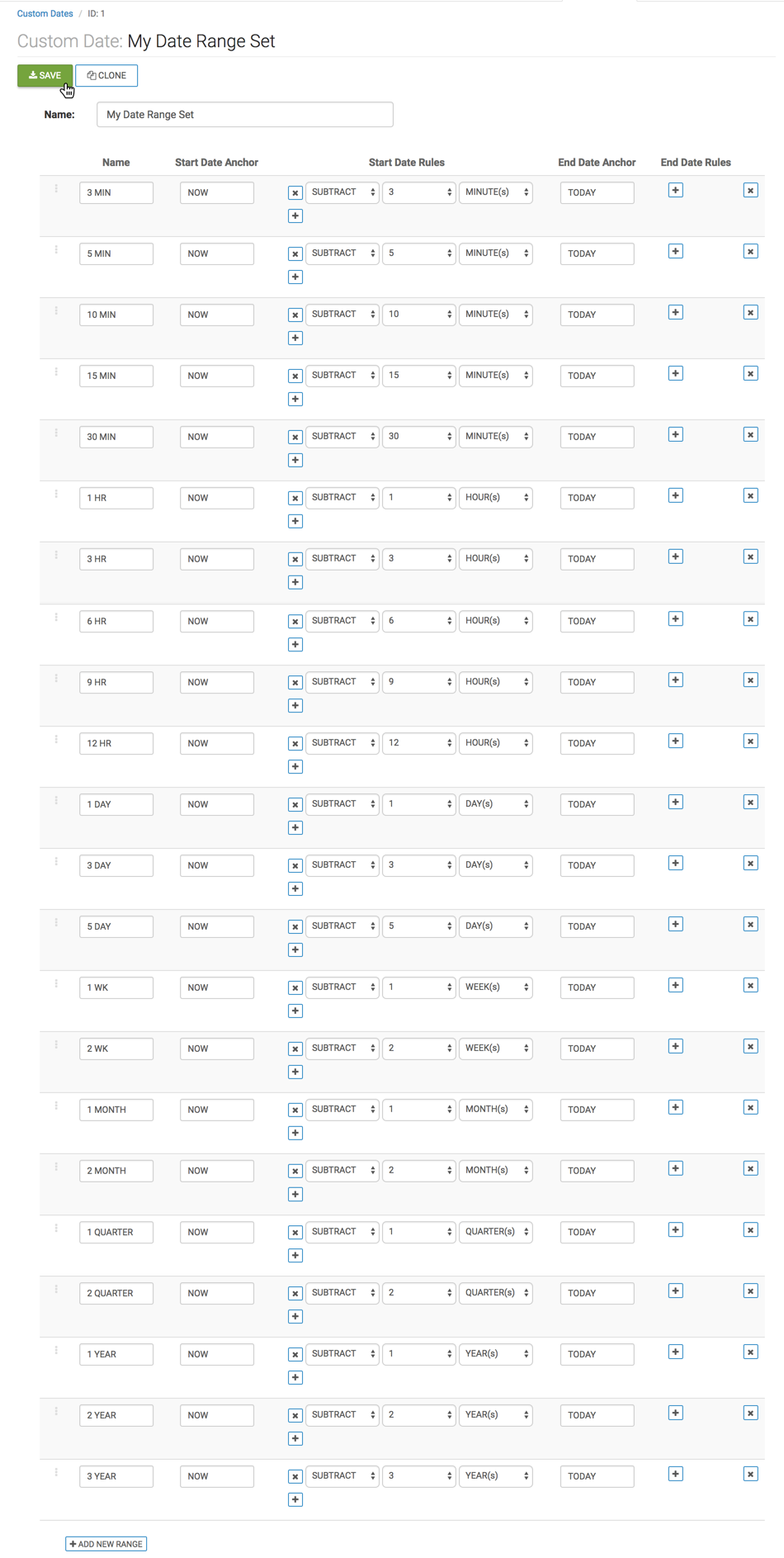

 - Click SAVE at the top of the interface to save the first date range.
        Following the earlier steps, create additional dateranges and click
            SAVE.

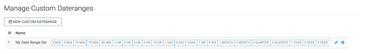

        In this example, the following dateranges have been created:
3 min5 min, 10 min, 15 min, 30 min, 1 hr, 3 hr, 6 hr, 9 hr, 12 hr, 1 day, 3 day, 5 day, 1 wk, 2 wk, 1 month, 2 month, 1 quarter, 2 quarter, 1 year, 2 year, 3 year
In the Manage Custom Dateranges interface, you can see that the list contains the new set, My Date Range, with all defined ranges.
