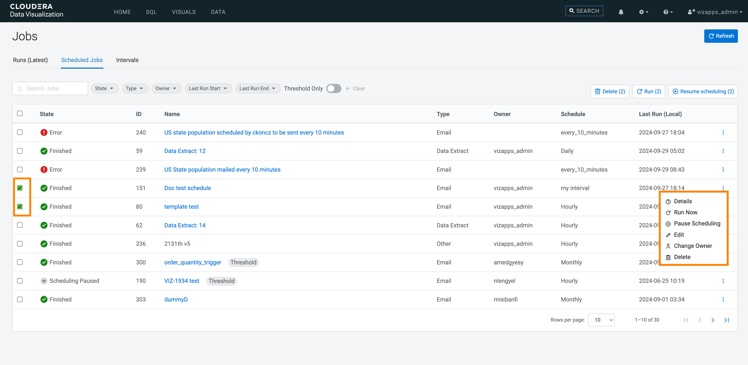

Pausing running jobs
- Navigate to Scheduled Jobs on the Jobs interface.
        Locate the job you wish to pause and click
located at the end of the job row to open the supplemental menu.
        To pause a single job, locate the job you wish to pause and click
To pause multiple jobs simultaneously, select them using the checkbox at the beginning of each row. If you want to pause all jobs, click the checkbox on the left side of the list header.
           - Click Pause Scheduling
        Click Pause in the confirmation modal to proceed with the
          action.
The modal lists the IDs and names of the jobs selected for pausing.
A notification that the job is paused appears briefly, the status of the job changes to Scheduling Paused, and the Pause Scheduling option is replaced with Resume Scheduling in the supplemental menu.

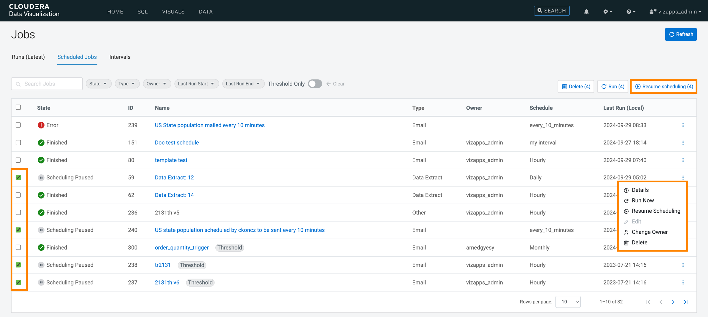

Resuming paused jobs
        To rerun a single job, locate the job you wish to resume and click
To resume multiple paused jobs simultaneously, select them using the checkbox at the beginning of each row. If you want to resume all jobs, click the checkbox on the left side of the list header.
           - Click Resume Scheduling
        Click Resume in the confirmation modal to proceed with the
          action.
The modal lists the IDs and names of the jobs selected for resuming.
A notification that the job is resumed appears briefly, the status of the job changes, and the Resume Scheduling option is replaced with Pause Scheduling in the supplemental menu.
