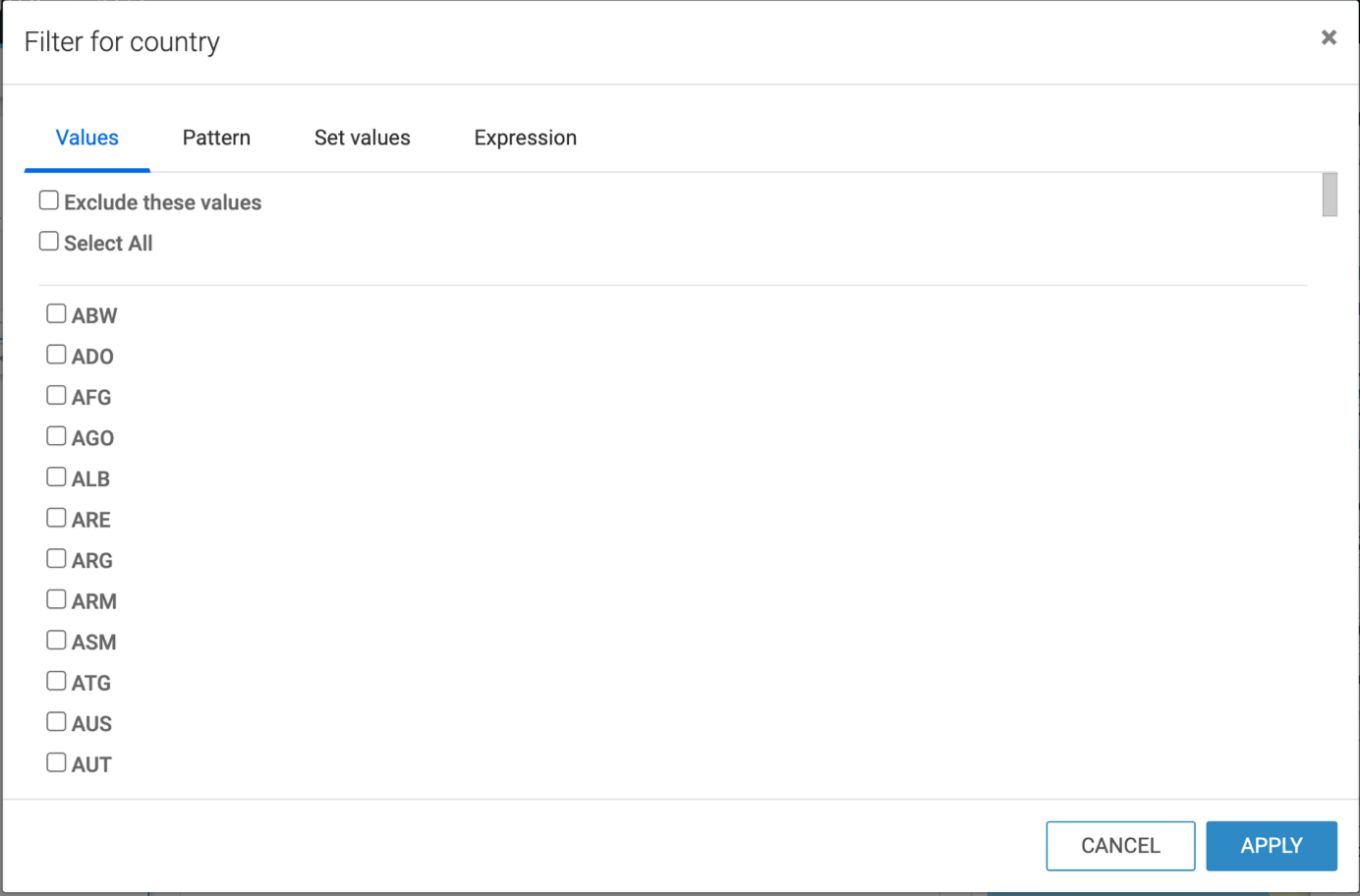

In this example, the country field is added to the filter shelf. A modal window pops up where you can set the values you want to filter for. You can choose discrete values, ranges, patterns, or use the Select All option for a bulk selection of the shown filter values.

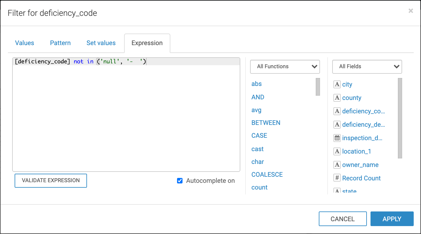

          You can also create your own custom filter expressions by using the Expression tab. In this example, the deficiency_code field is added to the filter shelf with a custom filter expression.
