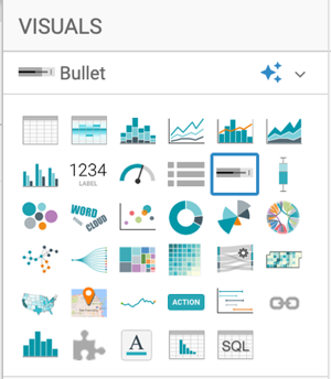

  2. In the VISUALS menu, find and click Bullet.

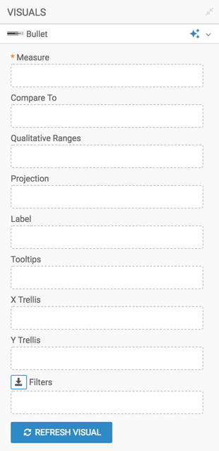

    The shelves of the visual changed. They are now Measure (mandatory), Compare To, Qualitative Ranges, Projection, Label, Tooltips, X Trellis, Y Trellis, and Filters.

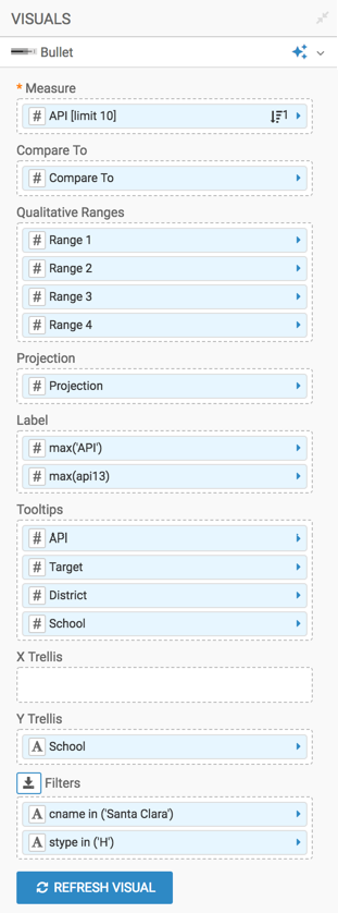

  3. Populate the shelves from the available fields ( in Dimensions and Measures) in the DATA menu.
    1. Measure - Add the field Api13, and change the aggregation, so that the shelf contains max([Api13]).
      [Optional] Limit the output to the top 10 performers:
      1. Click the (right-arrow) icon to the left of the field, and select the Order and Top K option.
      2. After the menu expands, enter 10 in the Top K option.
      [Optional] Alias the field as the name of the measurement. In this case, use API.
    2. Compare To - Add the field Api12. Then customize the expression to reflect whether the school reached the state-wide target of API=800.
      1. Click the (right-arrow) icon to the left of the field, and select the [ ] Enter/Edit Expression option.
      2. In the Enter/Edit Expression modal window, change the expression to the following formula:
        Max(if([Api12] < 800, [Api12] + [Target], 800))
      3. Click VALIDATE EXPRESSION to ensure that everything works.
      4. Click SAVE.
      [Optional] Alias the field as Compare To.
    3. Qualitative Ranges - Add the field Api12. Then, specify the equation that returns the upper limit of the first qualitative range. For this visual, simple scalar values are used.
      2. In the Enter/Edit Expression modal window, change the expression to the scalar value 600, and click SAVE.
      3. To create other ranges, simply click the (right-arrow) icon to the left of this field, and select the Duplicate option. Then open the Enter/Edit Expression modal window for the duplicate, change the value, and click SAVE.
        In this example, four ranges are defined: at 600, 700. 800, and 1000.
      4. [Optional] Alias the ranges as Range 1, Range 2, Range 3, and Range 4.
    4. Projection - Add the field Api13. Then, specify the equation that projects the current measurement to some future date.
      1. Click the (right-arrow) icon to the left of the field, and select the [ ] Enter/Edit Expression option in the FIELD PROPERTIES menu.
      2. In the Enter/Edit Expression modal window, change the expression to the following formula and click SAVE:
        if(max([Api13]) > 800, max([Api13]), max([Api13]) + 2 * max([Target]))
      3. [Optional] Alias the field as Projection.
    5. Label - Add the field Api13, and convert the aggregation to maximum, for max([Api13]).
      [Optional] Duplicate the field, and change its definition to max('API'), using the Enter/Edit Expression option in the FIELD PROPERTIES menu.. Move this field over the other field.
    6. Tooltips - Add more fields here, such as Api12, Target, Dname, Sname, and so on. You can apply an Alias to these fields.
    7. Y Trellis - Add the field Sname, and Alias it as School.
    8. Filters - Add the filters here. Cname is used in this example for name of the County (selecting Santa Clara), and Stype for school type (choosing H for high school).
    9. Y shelf - Ad the field Sname (school name) to trellis the visual.

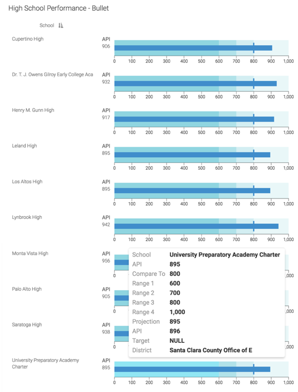

  6. Click REFRESH VISUAL.
    The new Bullet visual appears. Note that it is trellised, which is why it is sorted on the Sname field (school name), not on the measure Api13.
    Additionally, the Projection value is not visible; this is because it is relatively low for high-performing schools.

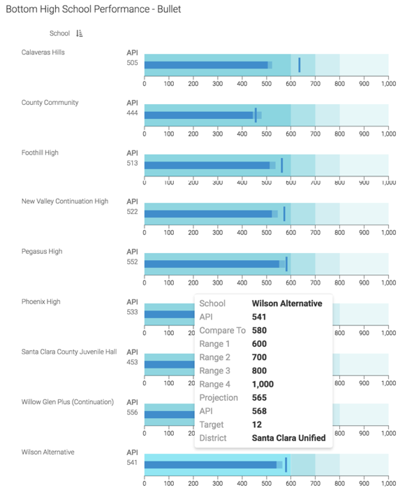

  7. Change the order property of the Measure shelf by selecting the Bottom K option with a value of 10, and click REFRESH VISUAL.
    Note that in all cases here, the projection value is visible because it is relatively large compared to the projected improvement for schools that already reached the 800 API threshold.
