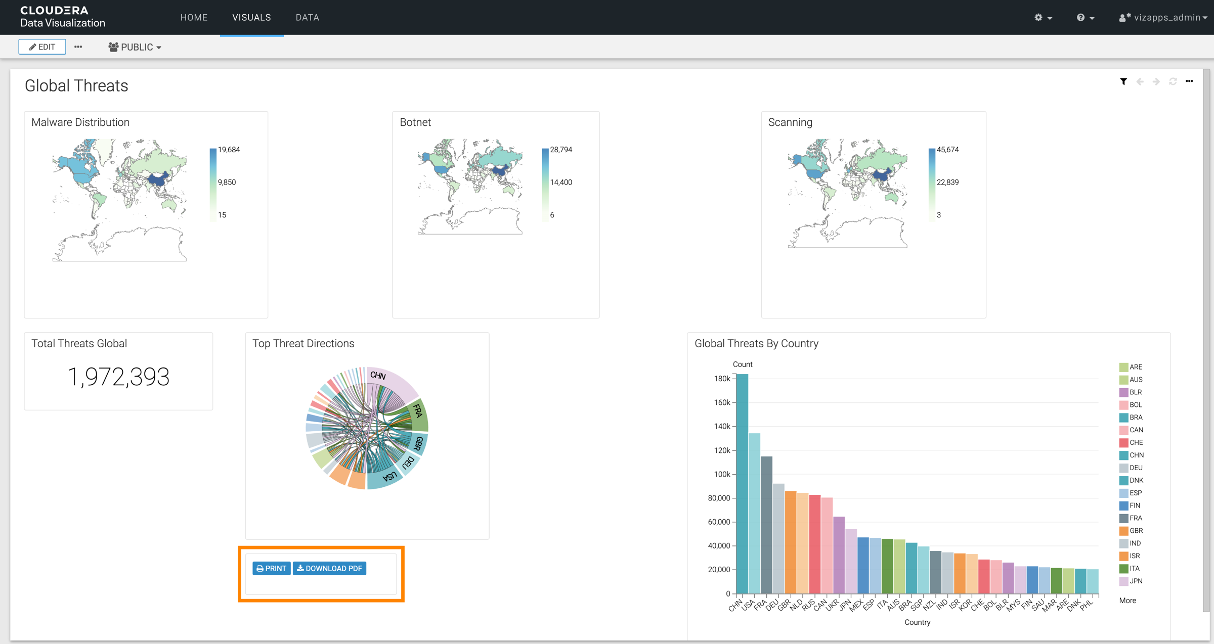

The following definition creates two buttons in an Extension visual:
  • Print button with an icon
  • Download PDF button with an icon
<div id="extension-print-and-pdf-btn">
  <button class="btn btn-xs btn-primary"
  onclick="window.print();return false;">
  <span class="fa fa-print"></span> Print</button>
  <button class="pdf-download btn btn-xs btn-primary">
  <span class="fa fa-download"></span> Download PDF</button>
  <div class="image-dropdown-submenu"/>
</div>
When you add this Extension visual to a dashboard, the dashboard will display print and download buttons:
