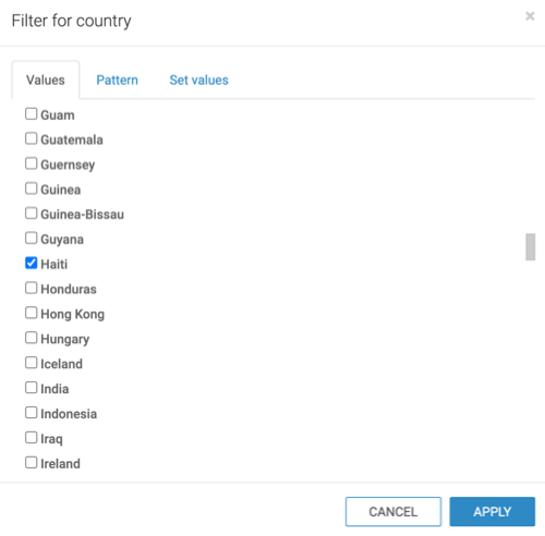

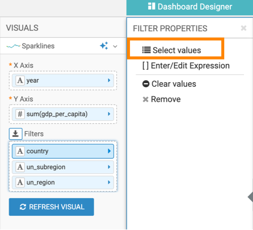

  • Follow these steps to create a Sparklines chart for a specific country:
    1. On the Filters shelf, click country and click Select values.
    2. In the Filter for country modal window, select Haiti and click APPLY.
    3. Click REFRESH VISUAL.
      You can see how the line has changed compared to the previous display (world-wide).

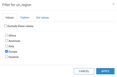

  • Follow these steps to create a Sparklines for a region, such as Europe:
    1. Clear the selection in the existing filters.
    2. From Dimensions, drag un_region to the Filters shelf.
    3. In the Filter for un_region modal window, select Europe and click APPLY.
    4. Click REFRESH VISUAL.
      You can see how the line has changed.
