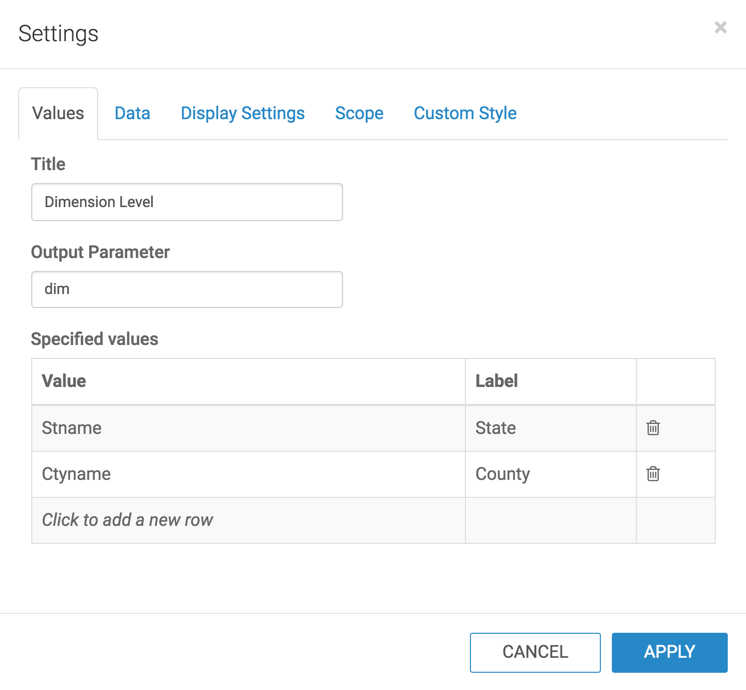

  3. Switch to the Values tab and enter the following:
    • Under Title, enter Dimension Level.
    • Under Output Parameter, enter dim. Note that this is the parameter from Creating visuals with variable dimensions.
    • Under Specified values, enter the following two rows:
      • Value: stname, Label: State
      • Value: ctyname, Label: County

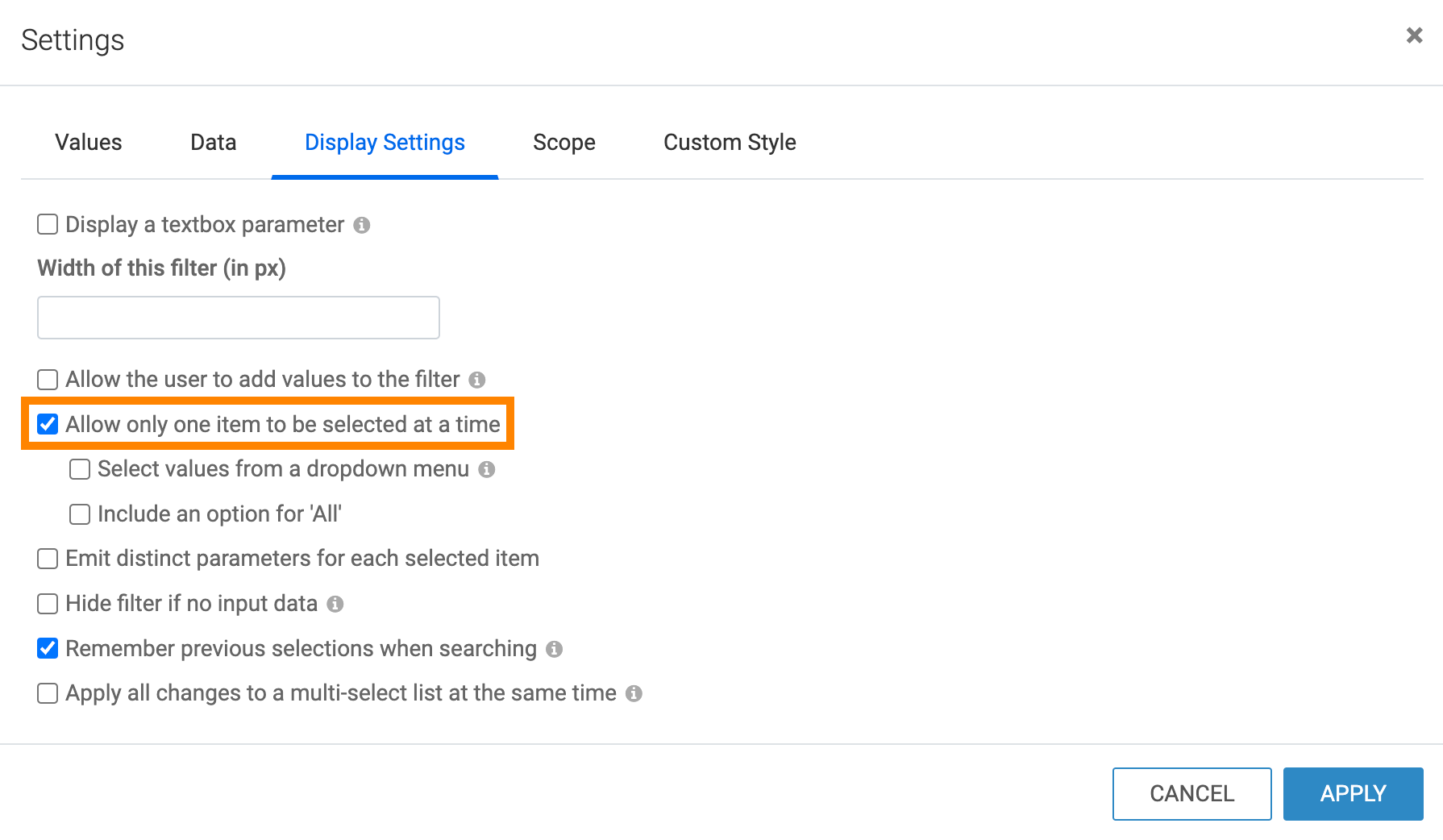

  4. Switch to the Display Settings tab and select the Allow only one item to be selected option.
  5. Click APPLY.
