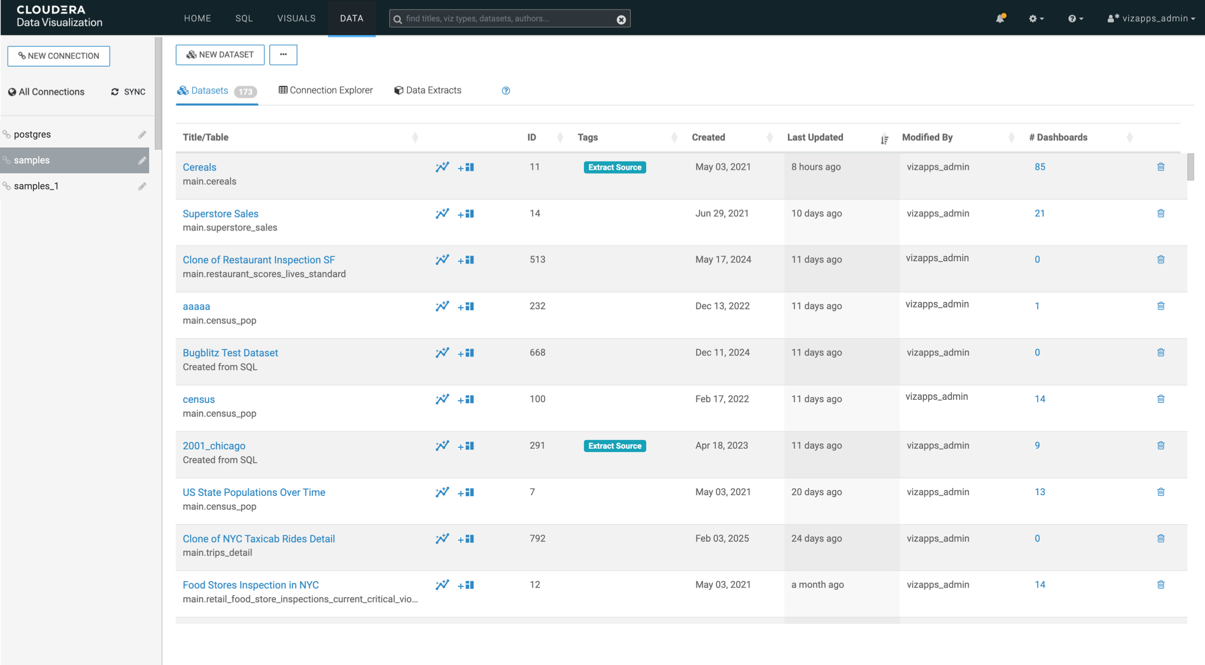

  1. On the main navigation bar, click DATA.
    The DATA opens, displaying the Datasets tab.
  2. On the side menu bar, click NEW CONNECTION.
    The Create New Data Connection modal window appears.
