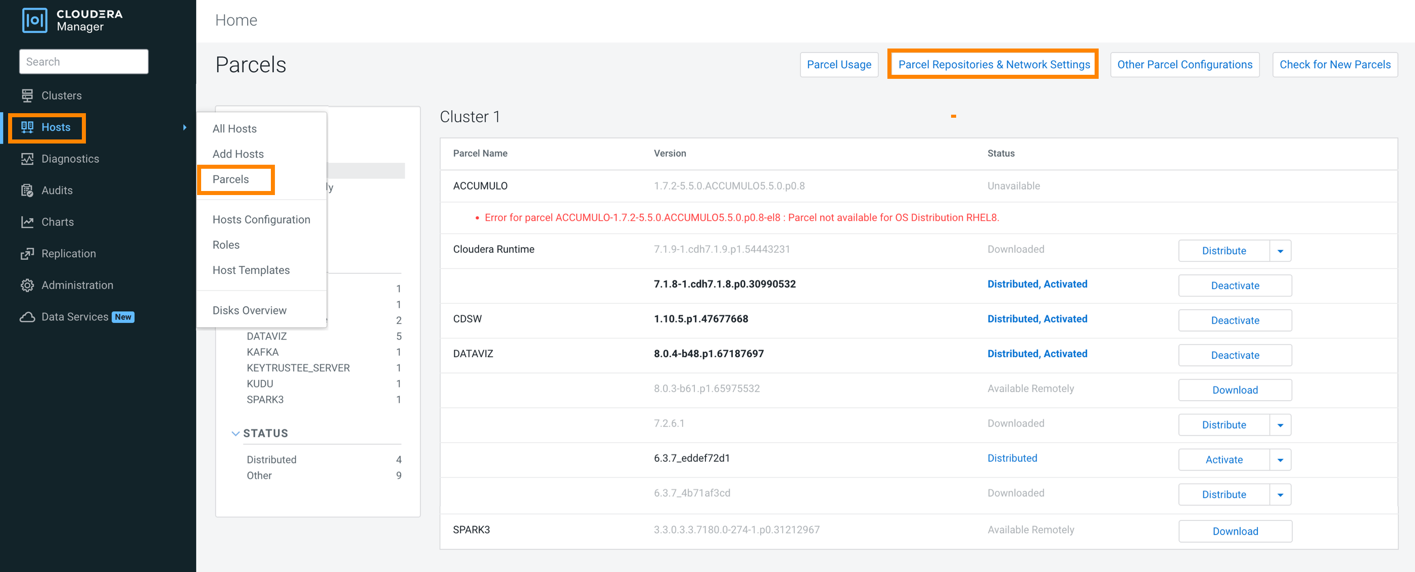

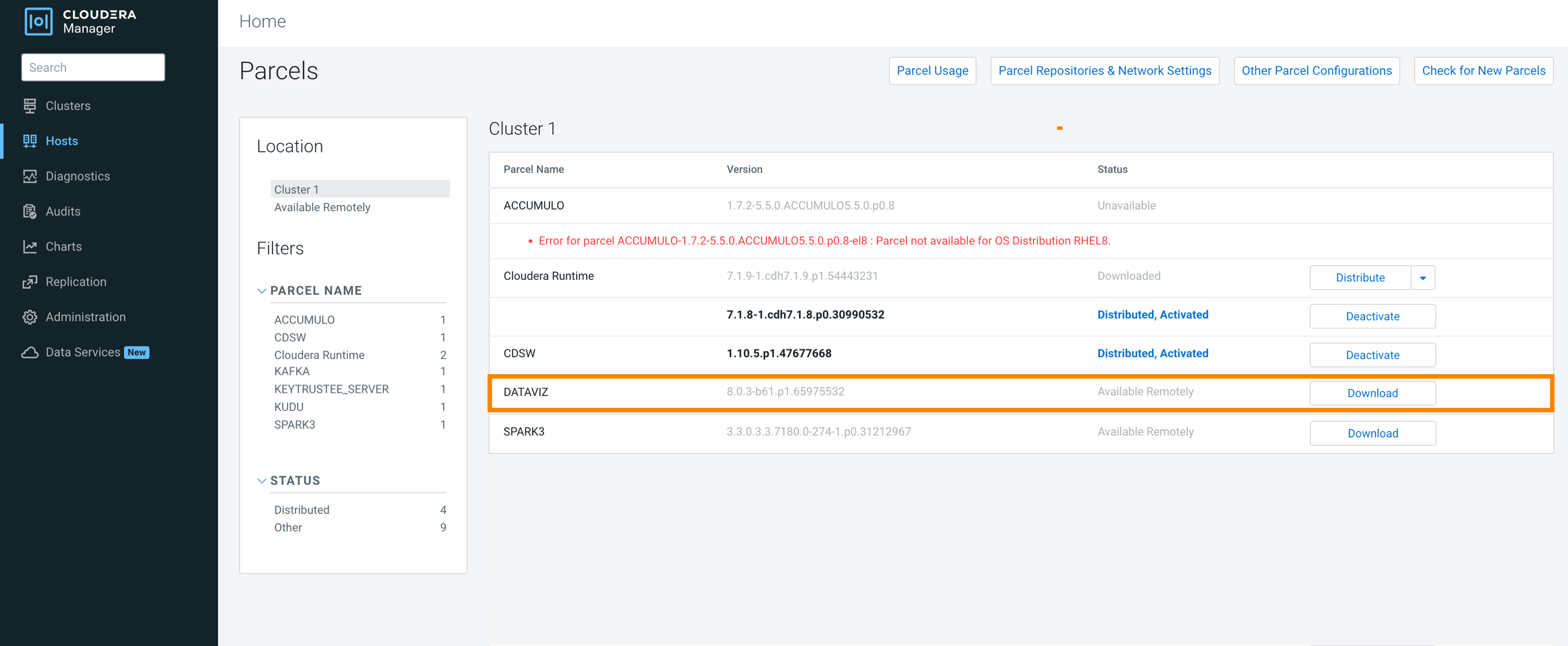

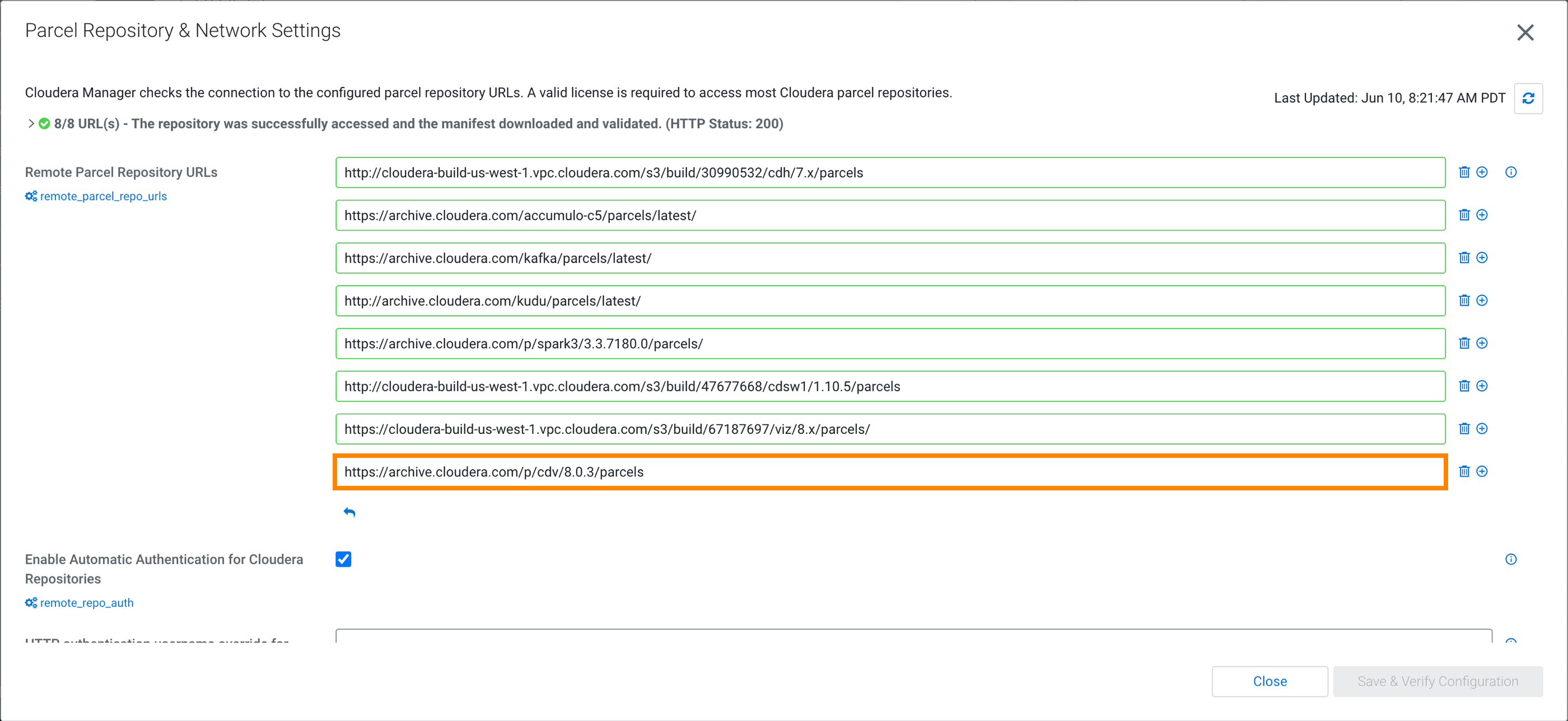

Adding Cloudera Data Visualization parcel repository to Cloudera Manager
Before installing Cloudera Data Visualization, you must set up two components: a Cloudera Data Visualization parcel and a Custom Service Descriptor (CSD).
This guide explains how to add the Cloudera Data Visualization parcel to Cloudera Manager. It involves updating the parcel repository URL, then downloading, distributing, and activating the parcel to make it available for installation.

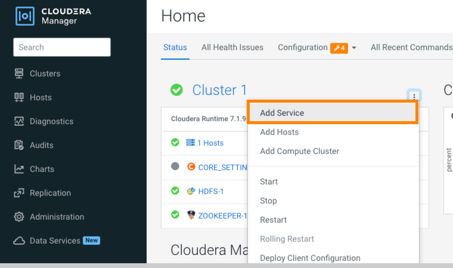

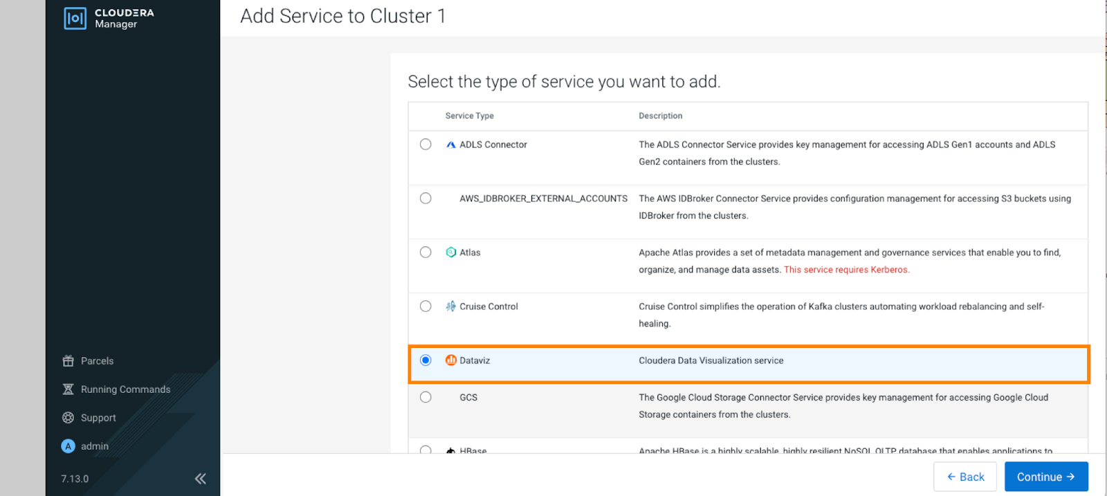

Adding Cloudera Data Visualization as a service
Use the Add Service wizard in Cloudera Manager to deploy and configure Cloudera Data Visualization on a Cloudera Base on premises cluster.
Ensure the following:
- A Cloudera Base on premises cluster is installed and running.
- You have added the Cloudera Data Visualization CSD files in the /opt/cloudera/csd folder, and Cloudera Manager has been restarted.
- You have added, downloaded, distributed, and activated the Cloudera Data Visualization parcel in Cloudera Manager.
You have completed your Cloudera Data Visualization installation on Cloudera Base on premises. For further information about adding services to Cloudera Runtime, see Adding a service.

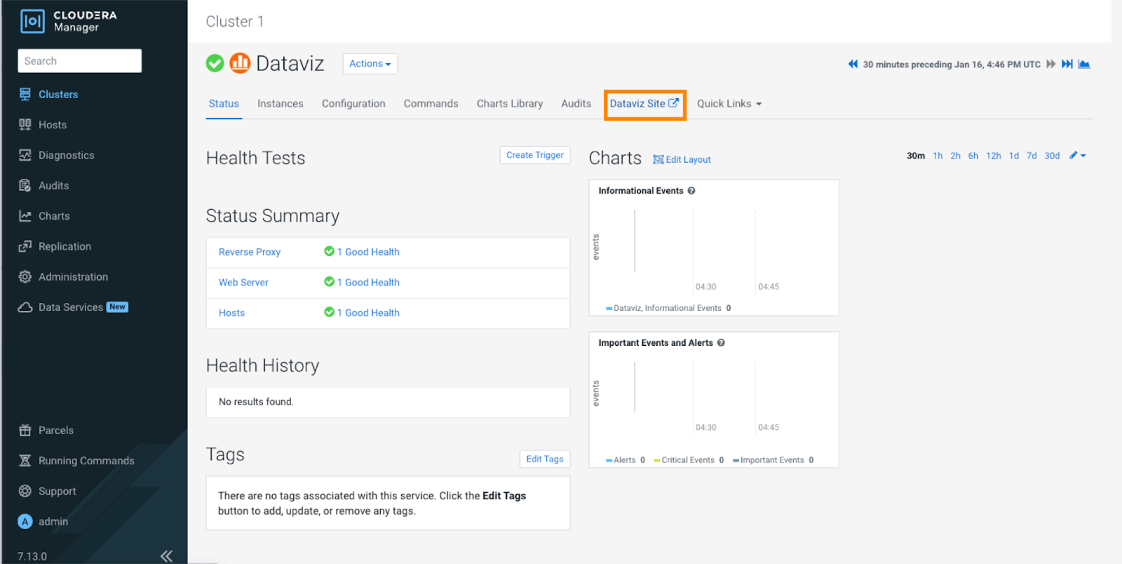

Open the Cloudera Data Visualization web interface to begin creating dashboards.
Accessing the Cloudera Data Visualization UI
After adding the service, follow these steps to access the Cloudera Data Visualization user interface.
