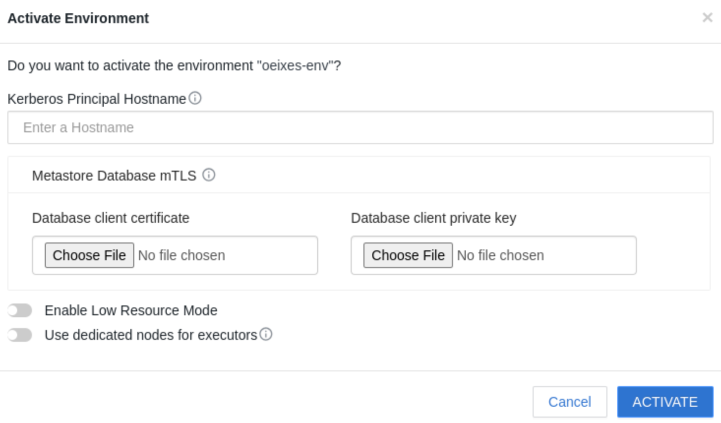

    The Activate Environment screen is displayed.
  5. In the Kerberos Principal Hostname field, enter the required hostname.
    If this field is blank, it will cause the activation to revert to the default behavior, requiring the two predefined Kerberos principals.
  6. Configure any additional environment settings as needed and click ACTIVATE.
