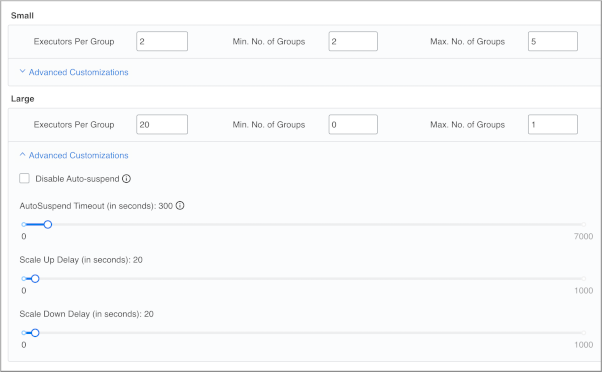

  2. In Size, select use workload aware autoscaling.
  3. In Small, which is an executor group set, configure Executors Per Group.
    The number of executors per group is analogous to the number of nodes you would need on a bare metal system to handle your workload. A small executor group set helps improve cost and prevents larger groups from starting up.
  4. In Large, which is your second executor group set, configure Executors Per Group.
    Choose a value that is a multiple of the value you set for the small Executors Per Group. The greater the spread between values of Executors Per Group the better the query routing.
  5. In Min No. of Groups, set the initial number of groups to use with no scaling down unless the Virtual Warehouse is suspended.
  6. In Max No. of Groups, set the upper limit for scaling, which is often based on budget or intolerance for query latency.
    An executor group set can contain up to 200 executors total. A group size (number of executors per group) must be within 1-100. The max no. of groups is limited by the group size . For example, a set with group size 2 can have up to 100 groups. A set with group size 100 can have up to 2 groups.
  7. Optionally, click Advanced Customizations for an executor group to configure Disable AutoSuspend, AutoSuspend Timeout, Scale Up Delay, Scale Down Delay.
  8. Optionally, click Add Custom Set to configure more scaling flexibility.

  9. In Custom1, configure executors per group, minimum number of groups, and maximum number of groups.
    Executors per group for a custom set cannot be less than executors per group for the small set or greater than executors per group for the large set.
    Custom sized executor group sets are named group-set-custom-1, group-set-custom-2, and so on.
