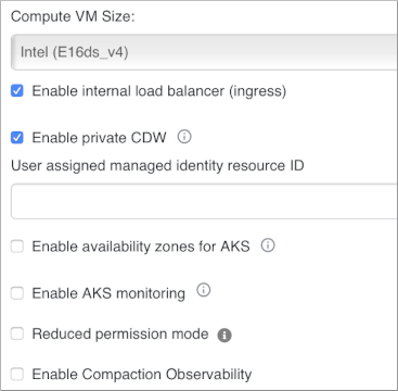

  3. In Activation Settings, optionally check Enable availability zones for AKS, and choose a subnet from the dropdown.
  4. Check Enable internal load balancer (ingress) to make endpoint access private.
    You must select this option to access Hue, DAS, and JDBC endpoints.
  5. Optionally, check Enable AKS monitoring, and then select the workspace from the adjacent dropdown.
  6. Check Enable private CDW to create a private cluster with UDR support, and in Whitelist IP CIDRs, enter 0.0.0.0/0.
  7. Optionally, check Use kubenet networking if IP address exhaustion is a concern for your deployment.
  8. Optionally, specify a custom cluster ID for your environment and resources.
