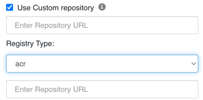

If you have an ECR repository, select the Use Custom ECR
repository option and specify the URL of the ECR repository with
https:// as a prefix.
Alternatively, if you have an ACR repository, select the Use Custom
repository option, choose the acr
reigstry type, and specify the URL of the ACR repository with
