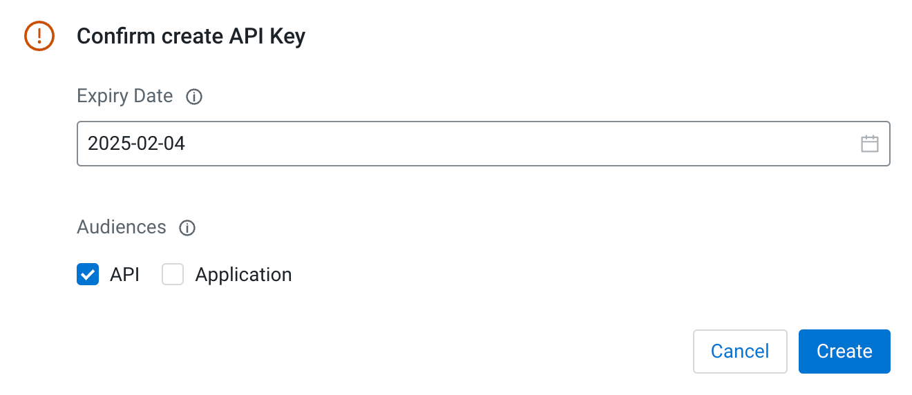

- In the Cloudera console, click the Cloudera AI tile. The Cloudera AI Workbenches page displays.
 - Click on the name of the workbench. The Workbenches Home page displays.
 - In , click Create API Key. The Confirm create API
       Key dialog box displays.
 - In Expiry Date, select the expiry date of the API key.
 - In Audiences, select the scope of the token. Application refers to the Cloudera AI Workbench applications and API refers to the Cloudera AI Workbench API v2. The generated key can be used to access API or applications.
 - Click Create.
