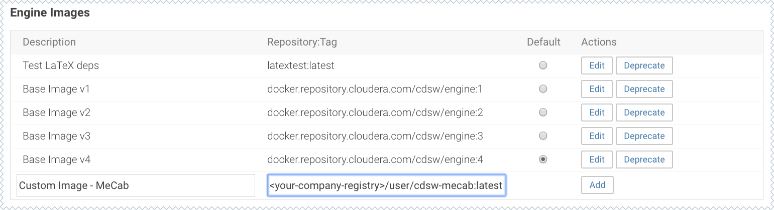

docker push <your-company-registry>/user/cdsw-mecab:latest - Whitelist the image,
<your-company-registry>/user/cdsw-mecab:latest. Only a site administrator can do this.Go to and add

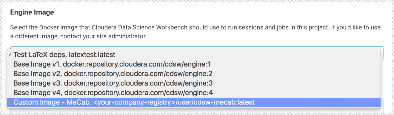

<company-registry>/user/cdsw-mecab:latestto the list of whitelisted engine images.
Ask a project administrator to set the new image as the default for your project. Go to the project Settings, click Engines, and select
company-registry/user/cdsw-mecab:latestfrom the dropdown.
