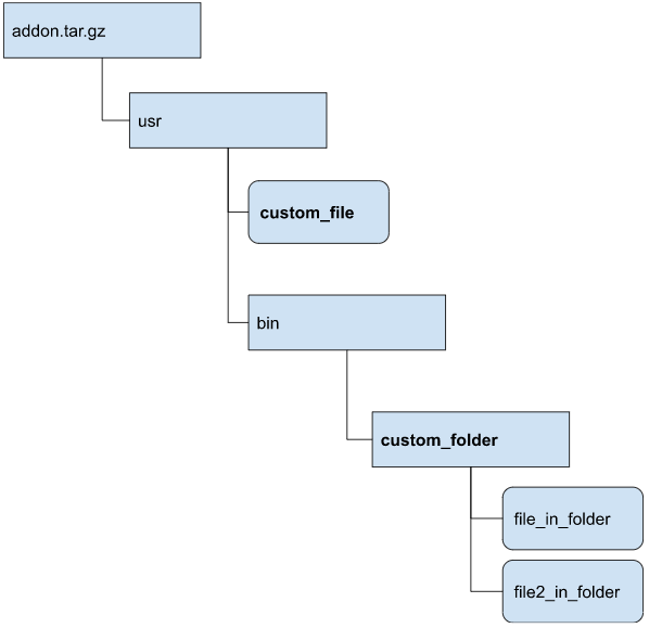

  1. Create a structure of files and folders with the following pattern and package it as a tar.gz archive file.
    For example, to mount a folder called custom_folder to the /usr/bin/custom_folder directory, and the custom_file folder to the /usr/custom_file directory, the tarball file has the following internal structure:
