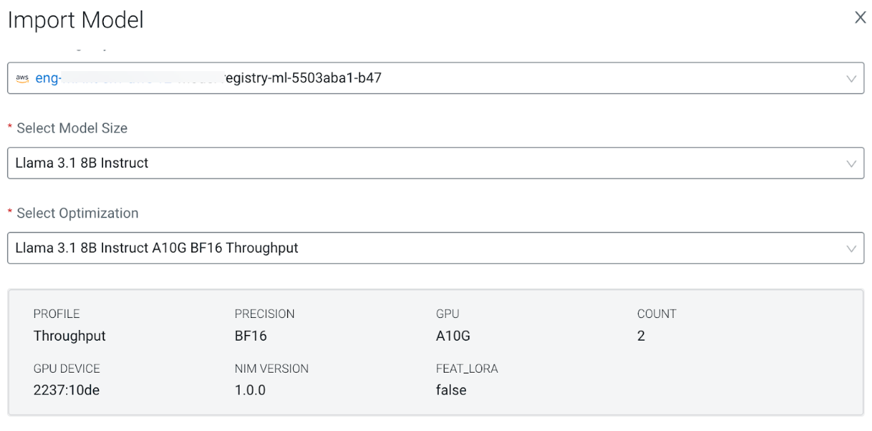

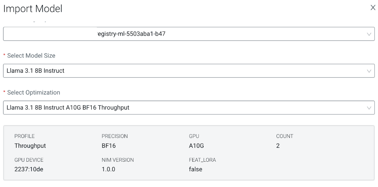

Consider the following example,when you deploy the following NVIDIA NIM for Llama 3.1:
In the above image, you can see that each replica of this model requires two A10G GPUs (due to the model being optimized for A10G with a tensor parallelism of two). You can assume that two replicas are required to handle normal traffic, but an additional replica would be required during peak traffic. Therefore, you must configure the model endpoint to autoscale between two and three replicas. Consequently, for normal traffic 4 A10G GPUs must be allocated, and two more for peak traffic. To ensure seamless rolling update for this model endpoint, and assuming updates are made during off-peak traffic, your cluster must be able to add eight A10G GPUs on-demand. An optimal node configuration for this scenario on AWS would be one that has 0-2 instances of the g5.12xlarge instance type. One instance runs two replicas during normal load, and the second instance is added using autoscaling during peak traffic, and during rolling update. Another, less cost-efficient, possibility is to use a single g5.48xlarge instance type in the node , in which case all the resource headroom is available on a single node. The larger node also helps to ensure that autoscaling model replicas and rolling updates are quicker as you do not have to wait for a new node to be spun up, and the container images to be pulled.

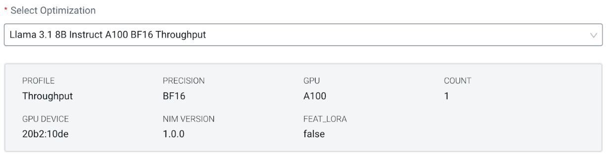

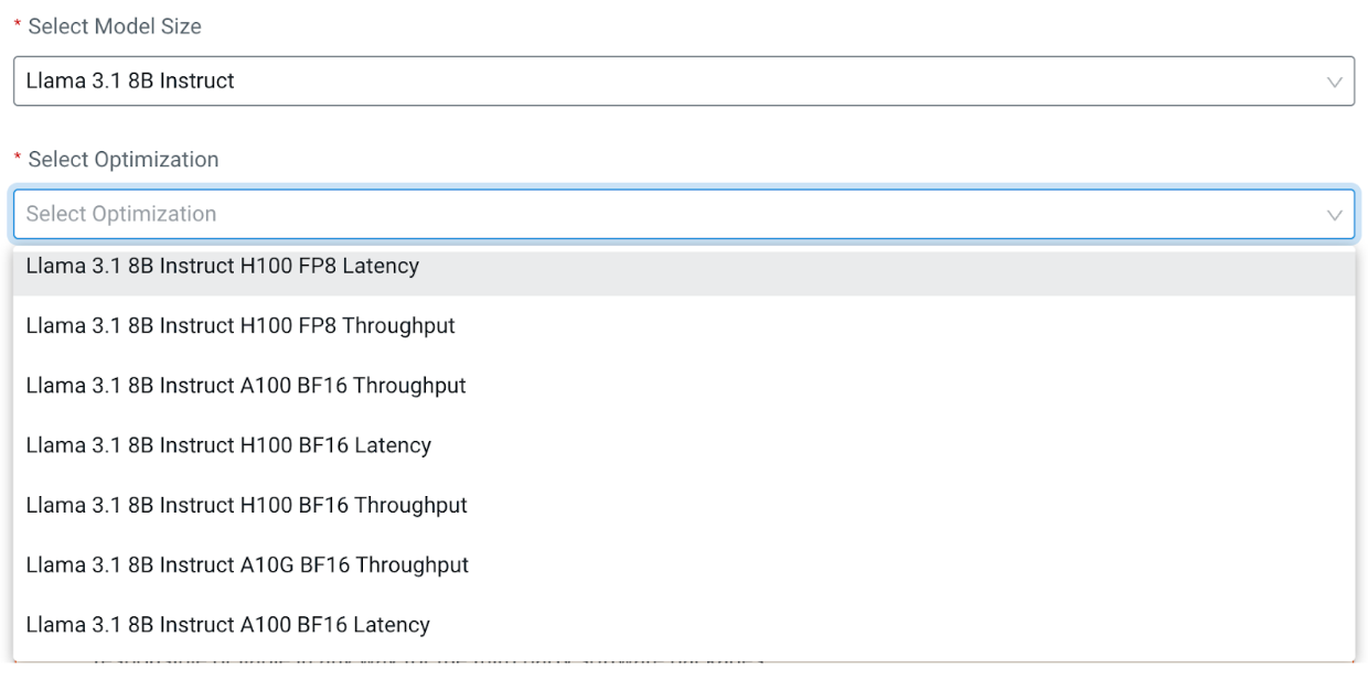

As an example, let us look at some of the available profiles for the instruction-tuned Llama 3.1 8b model. Each entry in the Optimization picker specifies the model name, GPU architecture, floating point precision, and profile type:
Let us compare the difference between A100 BF16 Throughput and A100 BF16 Latency profiles:
As shown in the figures, the GPU count per model replica of the latency profile is double the size of the throughput profile.
