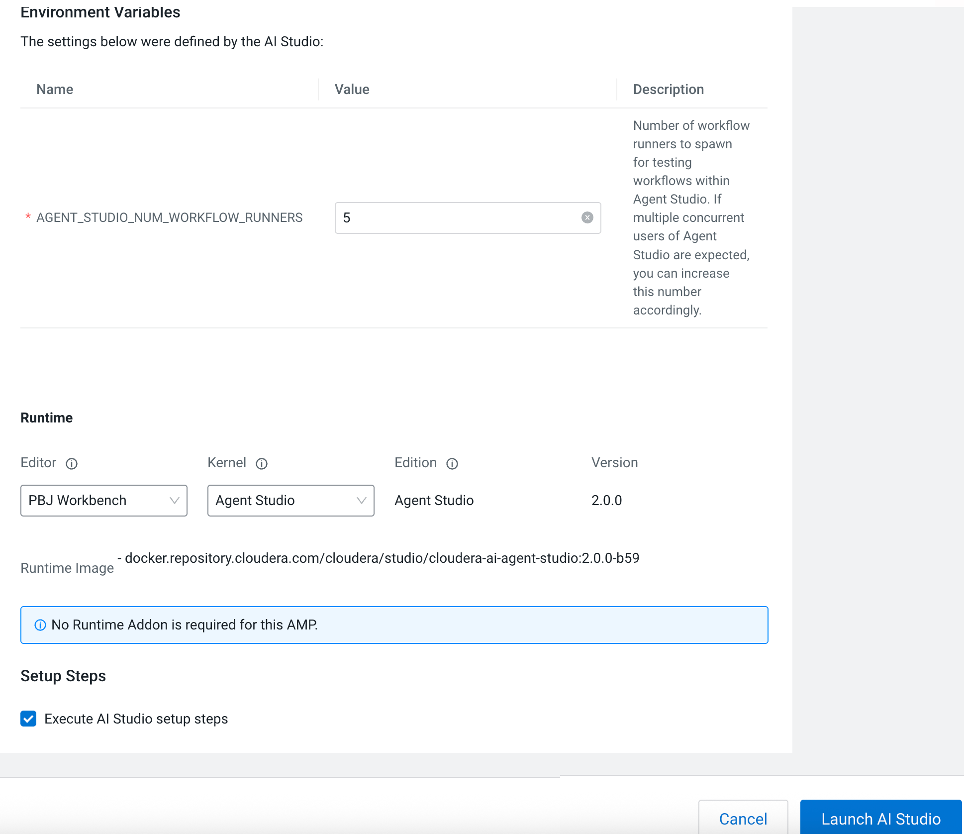

  5. Click the Launch button in the Agent Studio box to initiate installation in runtime mode. The Configure Studio: Agent Studio page is displayed.
  6. Set the environment variables for the Agent Studio.
  7. Select the Editor as PBJ Workbench.
  8. Under Runtime, select Agent Studio as the Kernel.
  9. Click Launch AI Studio.
