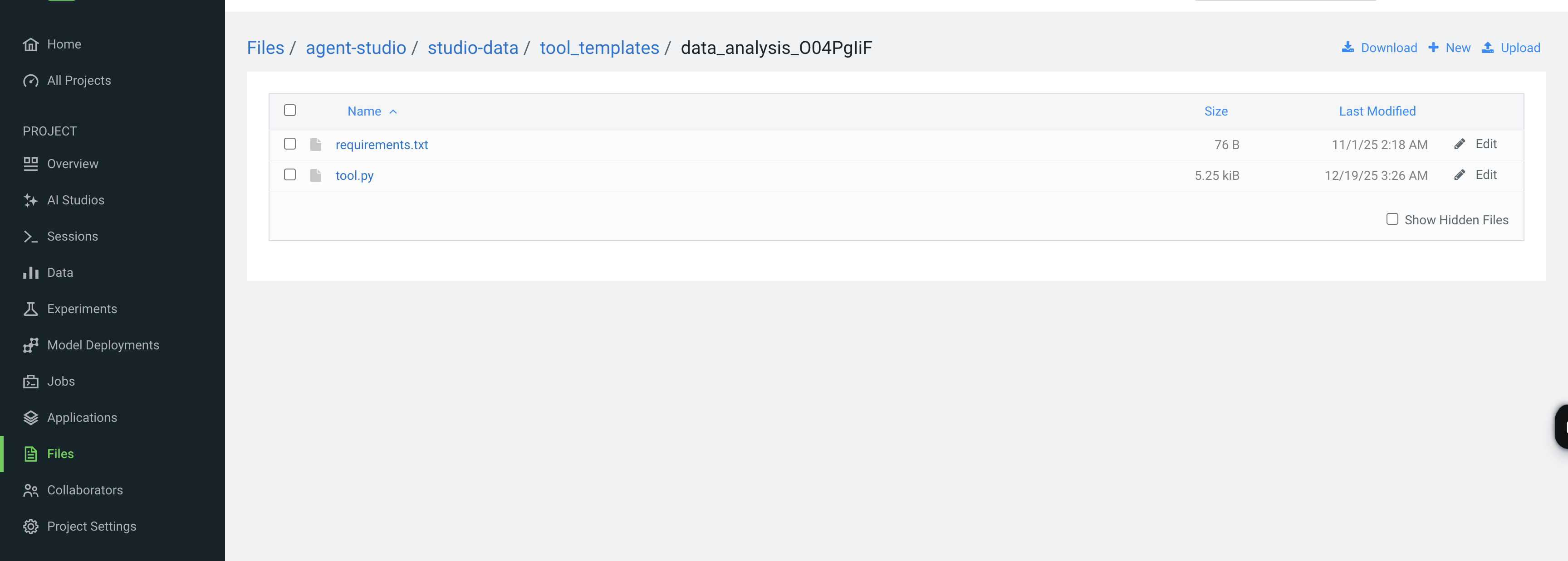

  7. Click Edit tool File. A direct link to the Files page in the AI Workbench UI is displayed.
  8. Edit the required details and test your changes.
    Figure 1. Tool files
