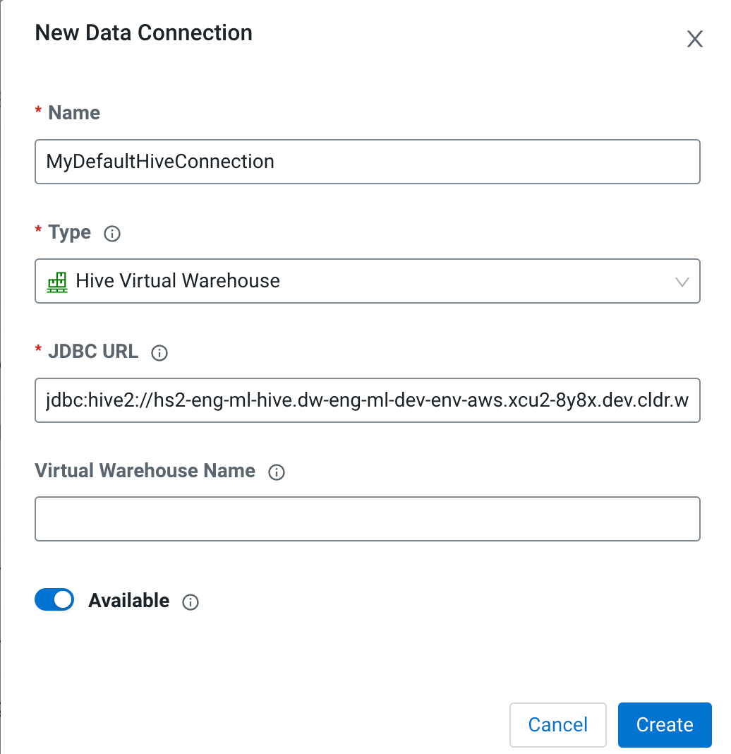

  5. Now click on the Build a Data Science Project tile to log into the the Cloudera AI Workbench.
  6. In Site Administration > Data Connections, select New Connection.
  7. Return to the Cloudera AI service. In Site Administration > Data Connections, select New Connection.
  8. Enter the connection name. You cannot have duplicate names for data connections within a workbench or within a given project.
  9. Select the connection type:
    1. Hive Virtual Warehouse
    2. Impala Virtual Warehouse
  10. Paste the JDBC URL for the data connection.
  11. (Optional) Enter the Virtual Warehouse Name. This is the name of the warehouse in Cloudera Data Warehouse.
The data connection is available to users by default. To change availability, click the Available switch. This switch determines if the data connection is displayed in Projects created within the workbench.
