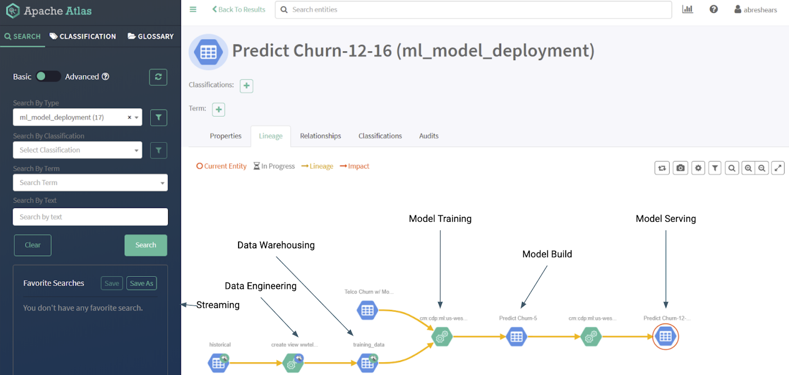

In addition to the definition of the types, Atlas also captures the relationship between the entities and processes to visualize the end-to-end lineage flow, as shown in the following image. The blue hexagons represent an entity (also called the noun) and the green hexagons represent a process (also called the verb).
The ML metadata definition closely follows the actual machine learning workflow. Training data sets are the starting point for a model lineage flow. These data sets can be tables from a data warehouse or an embedded csv file. Once a data set has been identified, the lineage follows into training, building and deploying the model.
