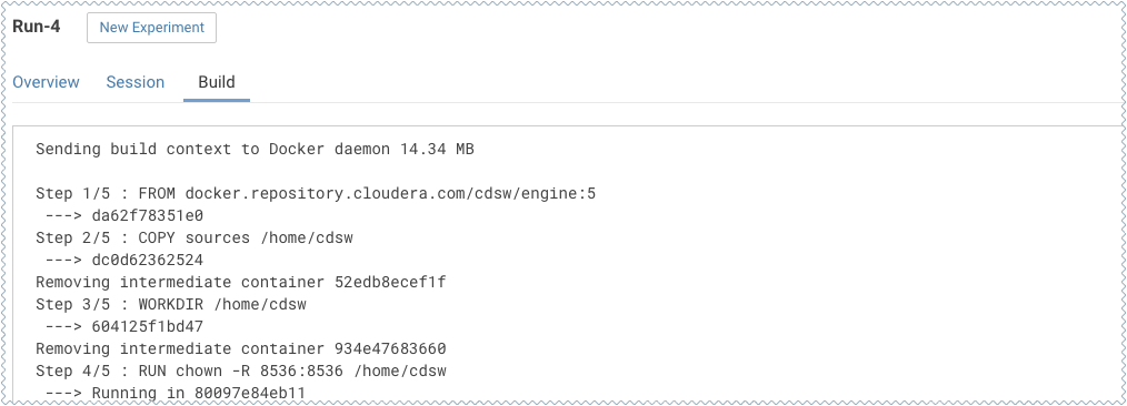

  6. To track progress for the run, go back to the project Overview. On the left navigation bar click Experiments. You should see the experiment you've just run at the top of the list. Click on the Run ID to view an overview for each individual run. Then click Build.
    On this Build tab you can see realtime progress as Cloudera Machine Learning builds the Docker image for this experiment. This allows you to debug any errors that might occur during the build stage.

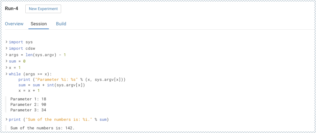

  7. Once the Docker image is ready, the run will begin execution. You can track progress for this stage by going to the Session tab.
    For example, the Session pane output from running add.py is:

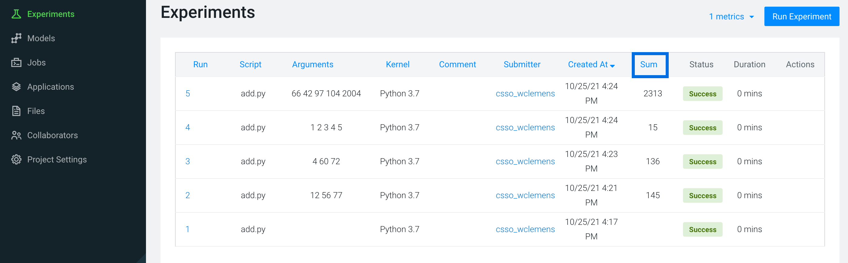

  8. (Optional) The cdsw library that is bundled with Cloudera Machine Learning includes some built-in functions that you can use to compare experiments and save any files from your experiments.
    For example, to track the sum for each run, add the following line to the end of the add.py script.
    cdsw.track_metric("Sum", sum)
    This will be tracked in the Experiments table:
