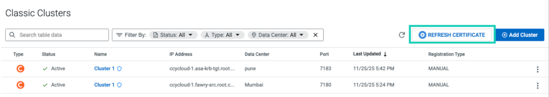

  1. Navigate to the Classic Clusters page in Cloudera Management Console.
  2. Copy the URL of the Cloudera Control Plane from the browser. The URL will be required for the update script.
    As an example for the Cloudera Control Plane URL:
    https://console.us-west1.cdp.cloudera.com/classic-clusters/

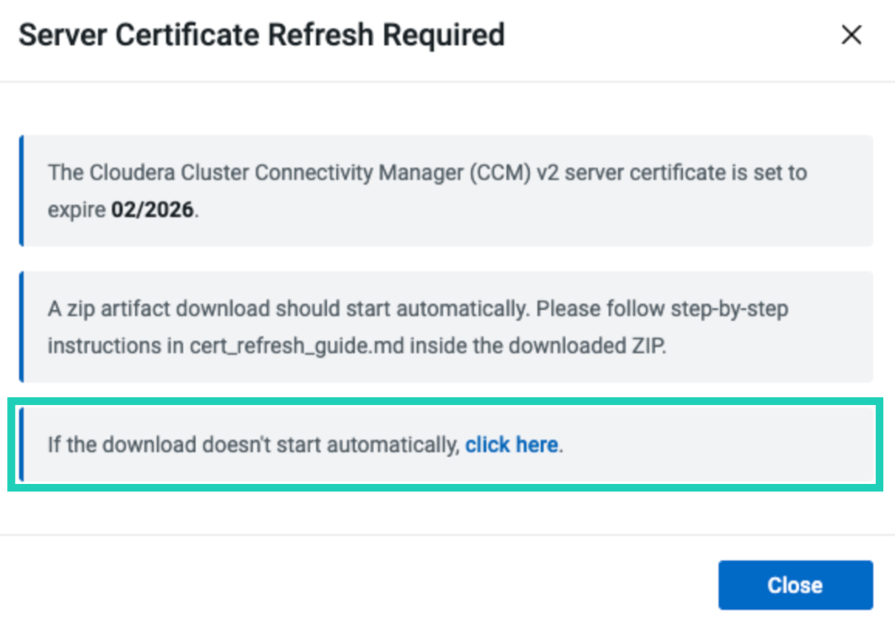

  3. Click on the Refresh Certificate button.
    The certificate_refresh_package.zip file is downloaded automatically to your local machine. In case the download does not start on its own, click the provided link in the window:

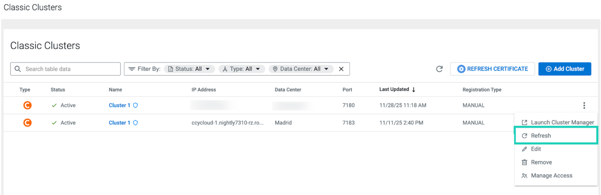

After successfully running the script, you can check connectivity from Cloudera on cloud using one of the following options:
  • Navigate to the Classic Clusters page in Cloudera Management Console, and select Refresh using button.
