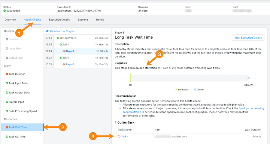

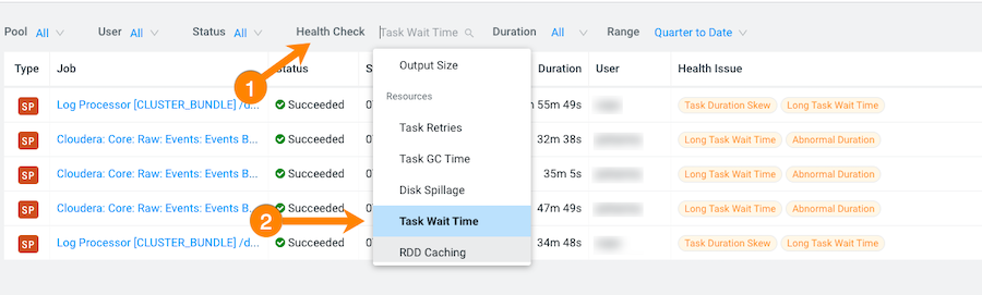

  7. From the Health Check filter's list, select Task Wait Time, which filters and displays a list of jobs with longer than average wait times before the process was executed.
  8. Display more details by selecting a job's name from the Job column and then clicking the Health Checks tab.
    The Baseline Health checks are displayed.
  9. From the Health Checks panel on the left, click the Task Wait Time health check, which opens a panel that describes the health check, displays information about the possible causes, and lists recommended solutions.
    In the following example, the long wait time occurred in Stage-5 of the job process due to insufficient resources. The Recommendation section lists items for you to complete that may resolve the problem and the specific outlier tasks that produced the unusual results:

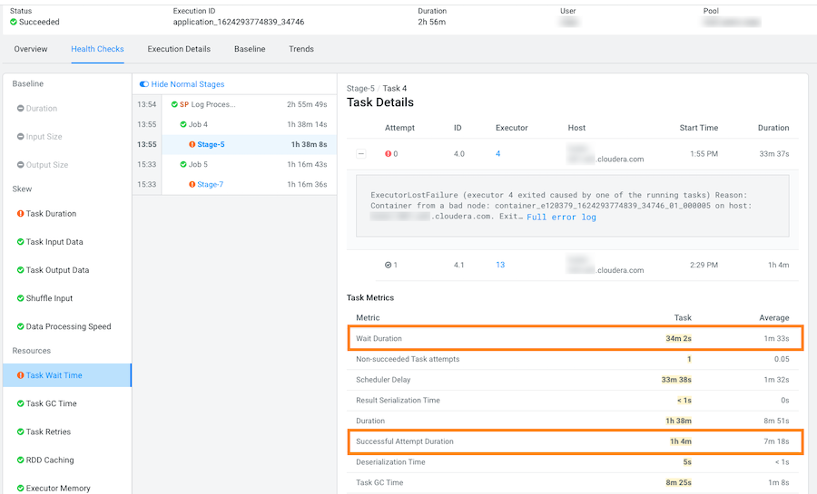

  10. To display more details about why this job is experiencing longer than average wait times, click one of the tasks listed under Outlier Tasks.
    In the following example, the Task Metrics section shows higher than average criteria measurement results and the Task Details reveal an ExecutorLostFailure error. This indicates a probable memory issue, where the container is exceeding the memory limits. In this case, more details may be found by clicking Full error log and reviewing the log:
