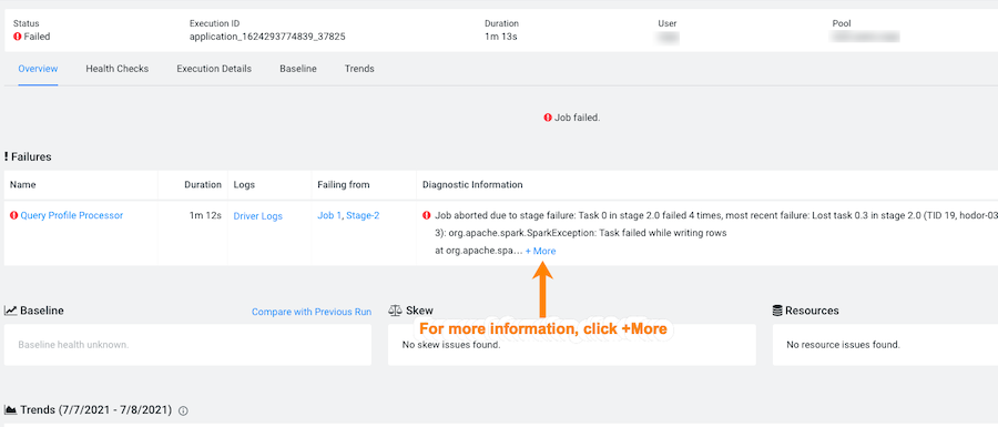

  5. In the Cluster Summary page, locate the Spark Jobs Trend chart widget and then click its Failed/Killed Jobs value.
    The engine's Jobs page opens.
  6. From the Health Check filter's list, select Failed to Finish, which filters the list to display a list of jobs that did not complete.
  7. To view more details about why a job failed to complete, from the Job column select a job's name. The job's page opens displaying information about the job you selected and where the failure happened.

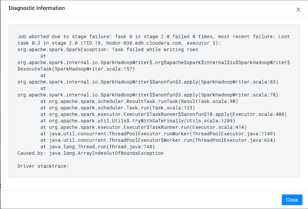

  8. From the Failures section in the Diagnostic Information column, click More.
    The Diagnostic Information dialog box opens, which describes more details about why the job aborted. In the following example, the job was aborted whilst writing rows due to an out of bounds java exception:
  9. Click Close.

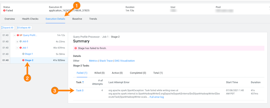

  10. To display more information about the stage where the job failed, in this case the Stage-2 process, in the Failing from column, click the stage's link. Or select the Execution Details tab and then click the failed stage's link.
    In the following example's Summary panel, it shows that Task 0 was attempted 4 times:

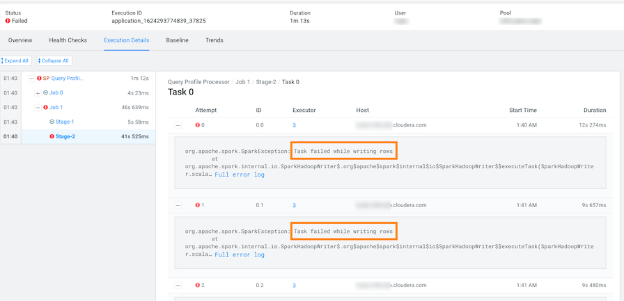

  11. To display more information about all the failed attempts, in the Summary panel, click the Failed task value.
    In the following example, the job aborted when Task 0 was writing rows. To understand more about what triggered the SparkException error message and to further troubleshoot the root cause, you can open the associated log file by clicking Full error log.
