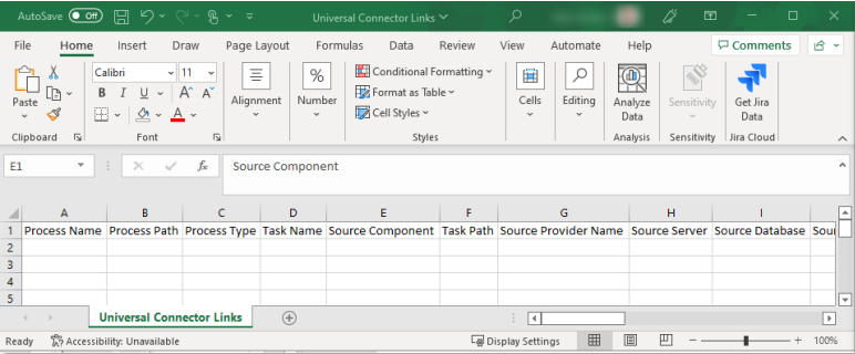

Process description
Refer to the respective tables below for the required information that must be added to the CSV files.
Universal Connector link
| Column Name | Description | Required |
| Process Name | Name of the process that wraps the task, for example “Workflow” in Informatica or “Package” in SSIS | No |
| Process Path | Path of the process – for example, the path where the SSIS package is stored, including the package name and suffix (aaa\bbb\ccc\Package Name.dtsx). | No |
| Process Type | The type of process – job, map, package, and so forth. | Yes |
| Process Description | Short process description to be identified clearly in the lineages. | No |
| Task Name | The task name – the atomic unit that holds the data flow within the process. | Yes |
| Task Path | The path of the task – the location of the atomic unit that runs the process (for example, aaa\bbb\ccc\Package Name\container\Task Name). | No |
| Source Component | Name of the logic component in the ETL tool. Example: for Informatica, the name of the aggregator in the map. When there is no component, enter the table name. | No |
| Source Provider Name | Provider of source object (for example, Oracle, SQL Server). | No |
| Source Server | Server name of the source object. | No |
| Source Database | Database name of the source object. | Yes |
| Source Schema | Schema name of the source object. | Yes |
| Source Object | Name of the source object. | Yes |
| Source Column | Column name in the source object. | Yes |
| Source Data Type | Data type of the column. | No |
| Source Precision | Precision of the column. | No |
| Source Scale | Scale of the column. | No |
| Source Object Type | Type of object – table, view, file. | Yes |
| Target Provider Name | Provider of target object (for example, Oracle, SQL Server). | No |
| Target Component | Name of the logic component in the ETL tool. Example: for Informatica, the name of the aggregator in the map. When there is no component, enter the table name. | No |
| Target Server | Server name of the target object. | No |
| Target Database | Database name of the target object. | Yes |
| Target Schema | Schema name of the target object. | Yes |
| Target Object | Name of the target object. | Yes |
| Target Column | Column name in the target object. | Yes |
| Target Data Type | Data type of the column. | No |
| Target Precision | Precision of the column. | No |
| Target Scale | Scale of the column. | No |
| Target Object Type | Type of object – table, view, file. | Yes |
| Expression | Formula or transformation between source column and target column. | No |
| Link Type | DataFlow or ImpactAnalysis. | No (default = DataFlow) |
| Link Description | Documentation about the link. | No (default = empty string) |

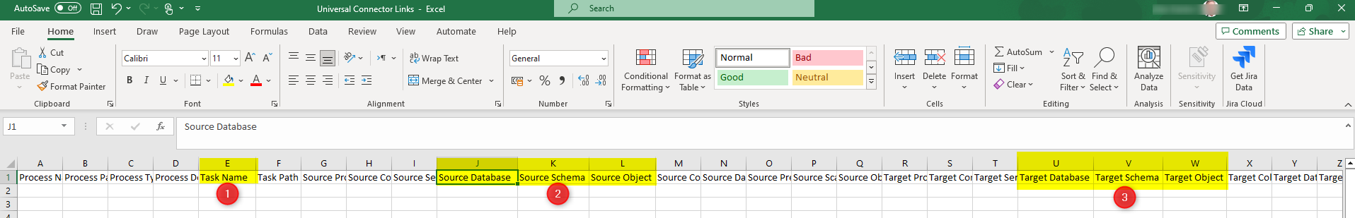

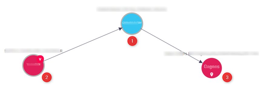

Example for ETL process on cross lineage
The Universal Connector links the source and the target for the task name as the main object.

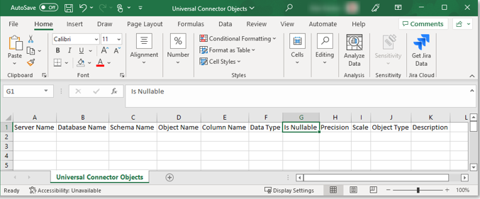

Universal Connector objects
| Provider Name | Provider of object – for example, Oracle, SQL Server. | No |
| Server Name | Server name of the object. | No |
| Database Name | Database name of the object. | Yes |
| Schema Name | Schema name of the object. | Yes |
| Object Name | Name of the source object. | Yes |
| Object Description | Documentation about the object. | No (default = empty string) |
| Column Name | Column name in the source object. | Yes |
| Column Description | Short column description. | No (default = empty string) |
| Is Nullable | Indicates whether the column accepts null values. | No |
| Object Type | Type of object – table, view, file, and so on. | Yes |
