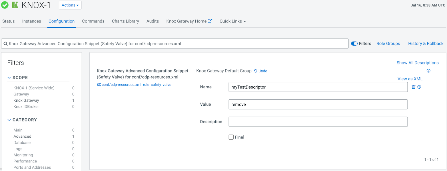

- In Cloudera Manager, select the Knox service.
- Go to Configuration.
- Find the Knox Gateway Advanced Configuration Snippet (Safety Valve) for conf/cdp-resources.xml advanced configuration snippet.
Click the + icon, and add the following entries
- Set the Name to the name of the descriptor that you want to delete.
- Set the Value to
remove.
In this example, we remove themyTestDescriptorcustom descriptor.

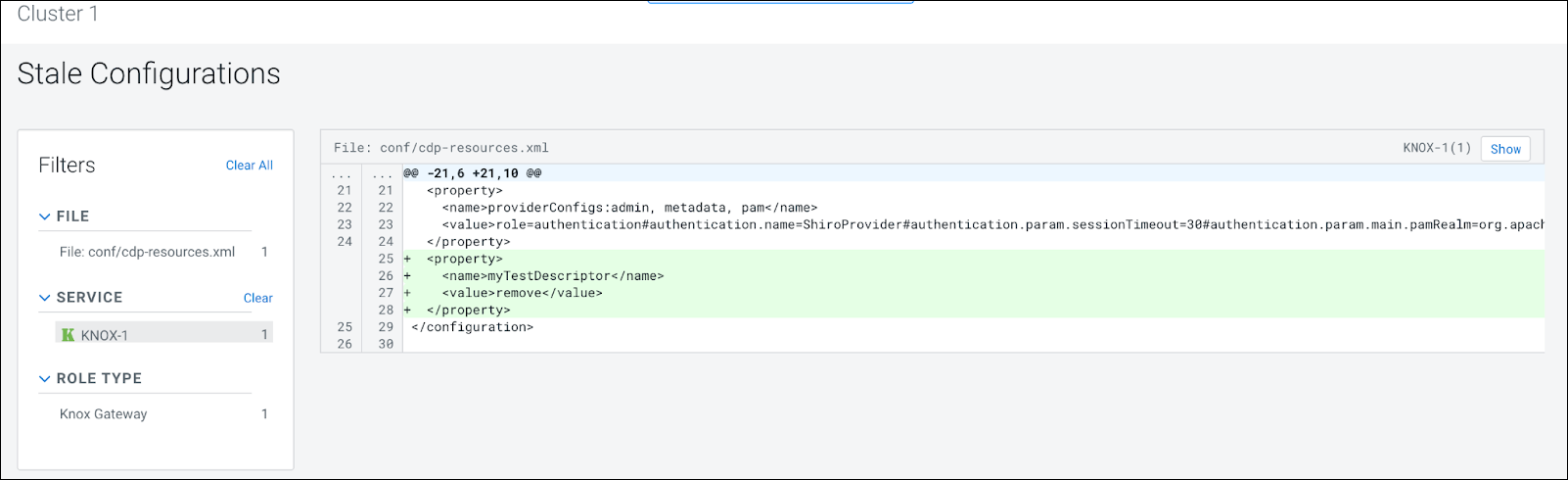

- Click the Save Changes(CTRL+S) button.
Refresh the Knox instances configuration by clicking the Stale
Configuration: Refresh needed indicator and wait until the
refresh process completes.
