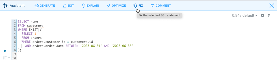

  2. Insert a SQL query in the Hue editor that you would like to fix.
  3. Click Assistant on the Hue SQL editor:
  4. Click FIX.
    Screenshot showing how to use the SQL AI Assistant in Hue to fix a SQL query.

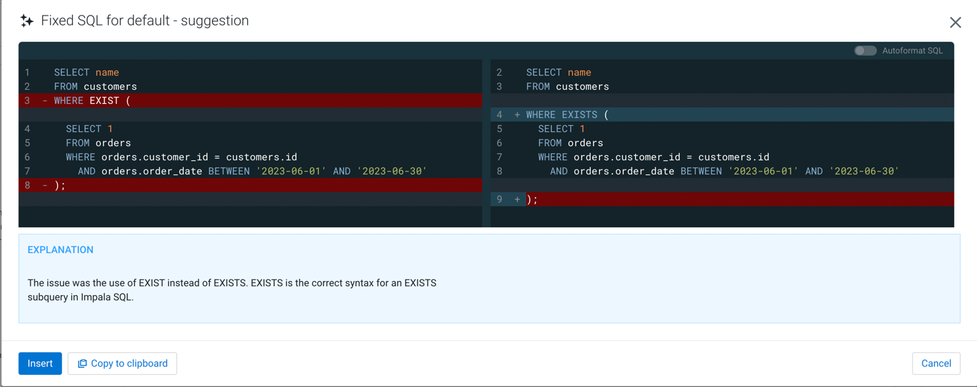

    Hue displays the original and the fixed SQL query in a side-by-side comparison.
    Screenshot showing the original and the fixed SQL query generated using SQL AI Assistant in Hue along with an explanation.
    Click Insert to insert the fixed query in the Hue editor and run it.
