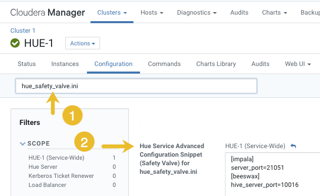

  2. Go to Clusters > Hue > Configuration
  3. In the Search text box, type hue_safety_valve.ini to locate the configuration parameter:
  4. Add the following parameters with your custom logo SVG code to the Hue Service Advanced Configuration Snippet (Safety Valve) for hue_safety_valve.ini configuration parameter:
