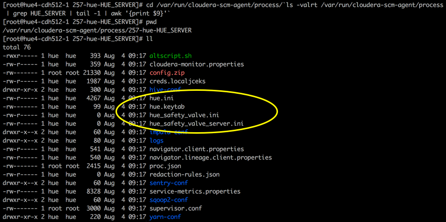

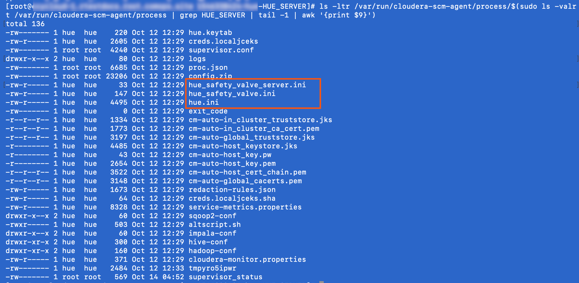

Run the following command to view the .ini files per process ID:
ls -ltr /var/run/cloudera-scm-agent/process/`ls -valrt /var/run/cloudera-scm-agent/process | grep HUE_SERVER | tail -1 | awk '{print $9}'`
Figure 1. Terminal showing Hue configuration files
