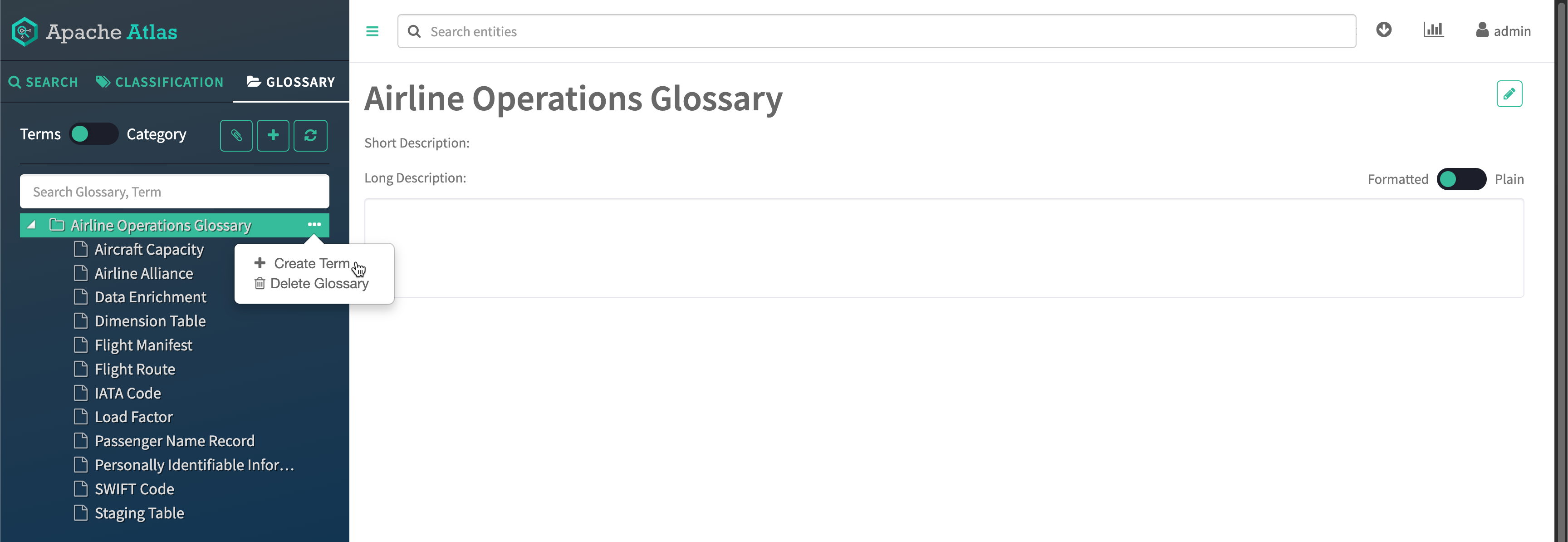

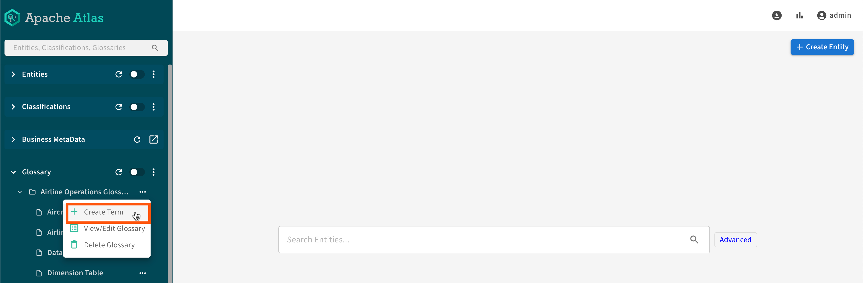

To create a glossary term, go to the Glossary tab in the left navigation panel:

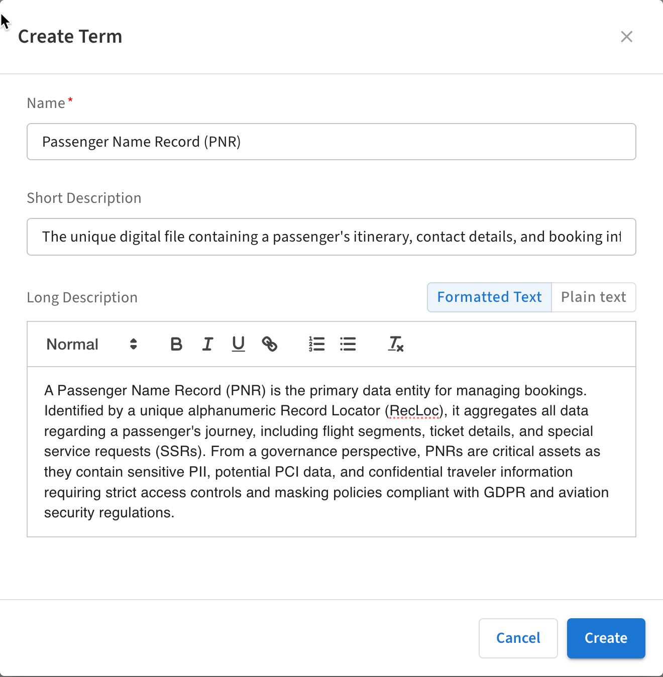

- Click + Create Term.
- Enter the new term and its descriptions, then click
Create.
- Switch the toggle to Terms.

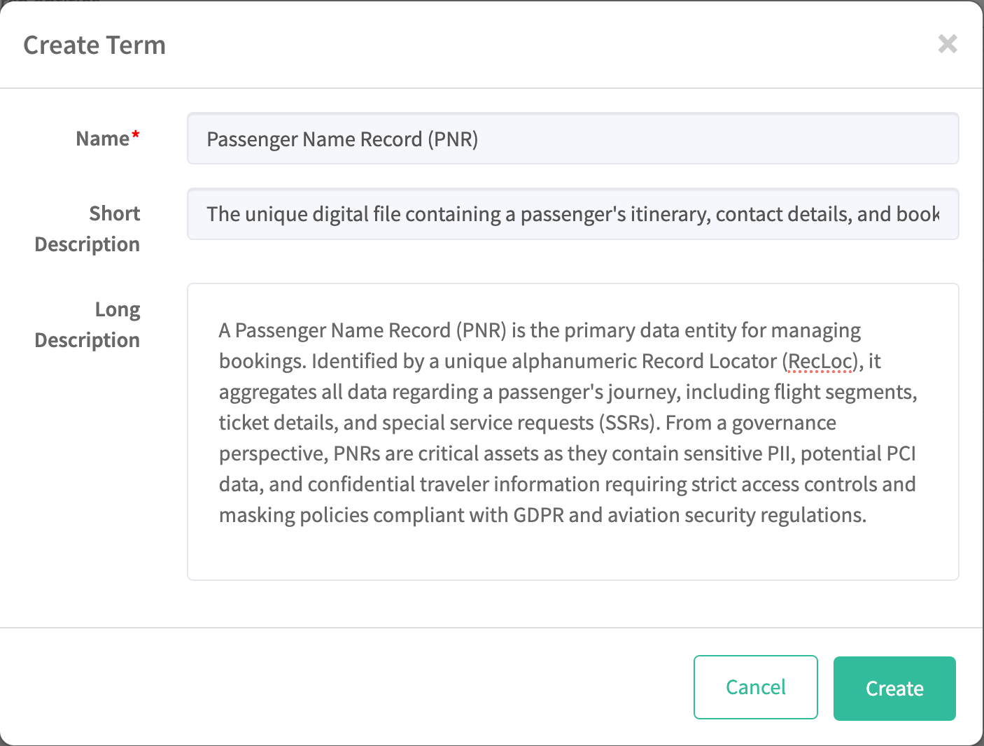

Create.
