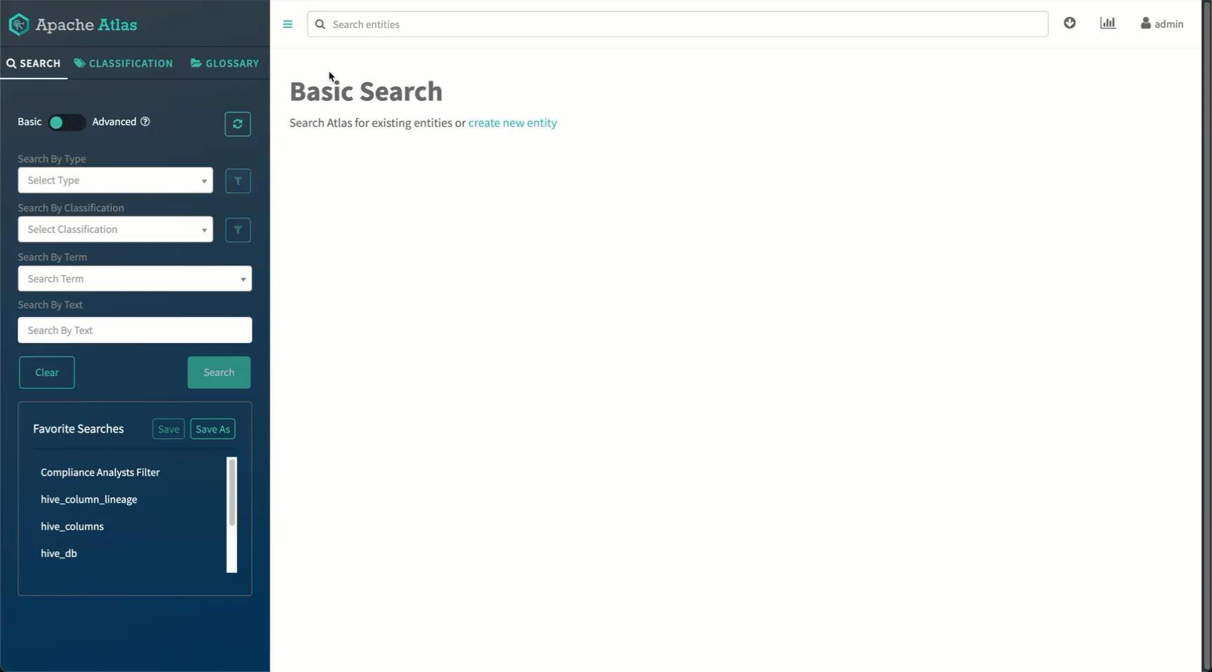

In the left navigator pane, Search tab, switch to Advanced Search mode by sliding the green toggle button from Basic to Advanced.
Select an entity type if appropriate, then add your query to refine the search results. Here are some examples of advanced search queries:
