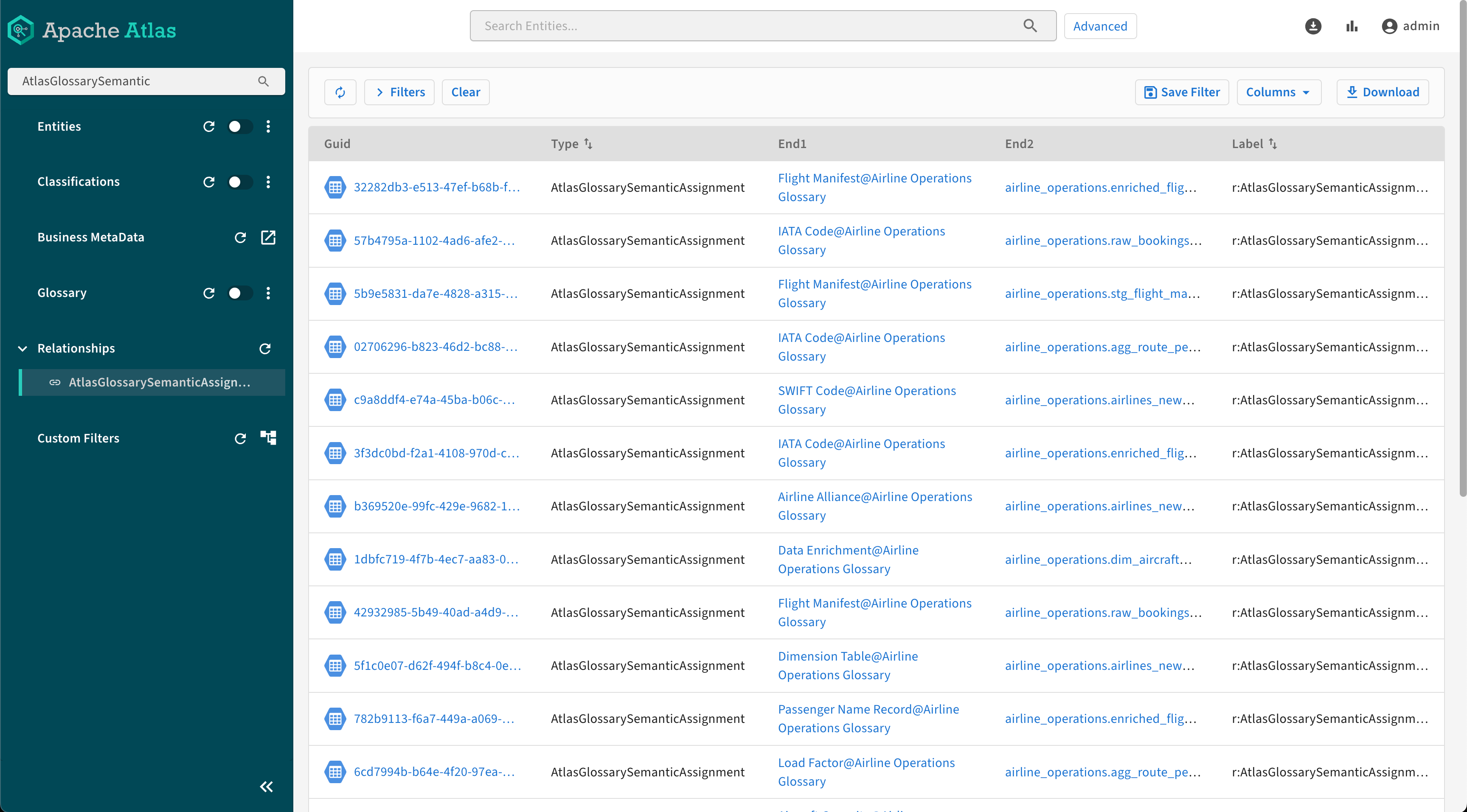

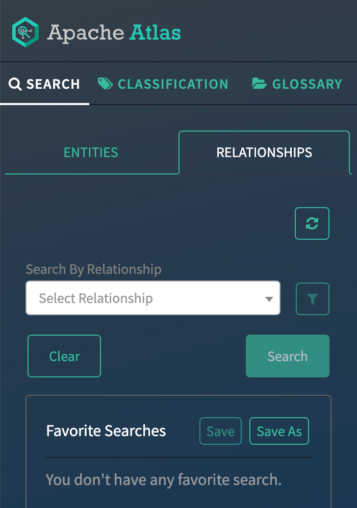

In Atlas, once the atlas.relationship.search.enabled property is set to true, you can switch between Entity Search and Relationship Search in the classic user interface:

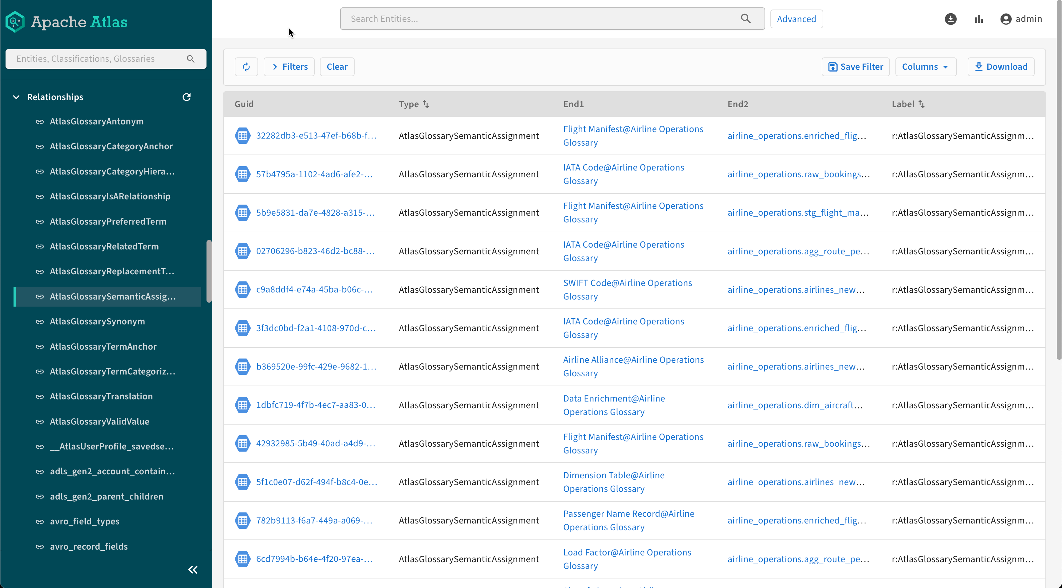

When using the new user interface, Relationships will appear in the Basic Search pane, following the other metadata categories, such as, Entities, Classifications, Glossary.

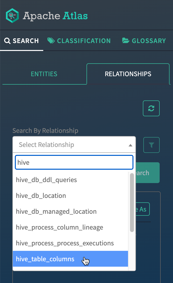

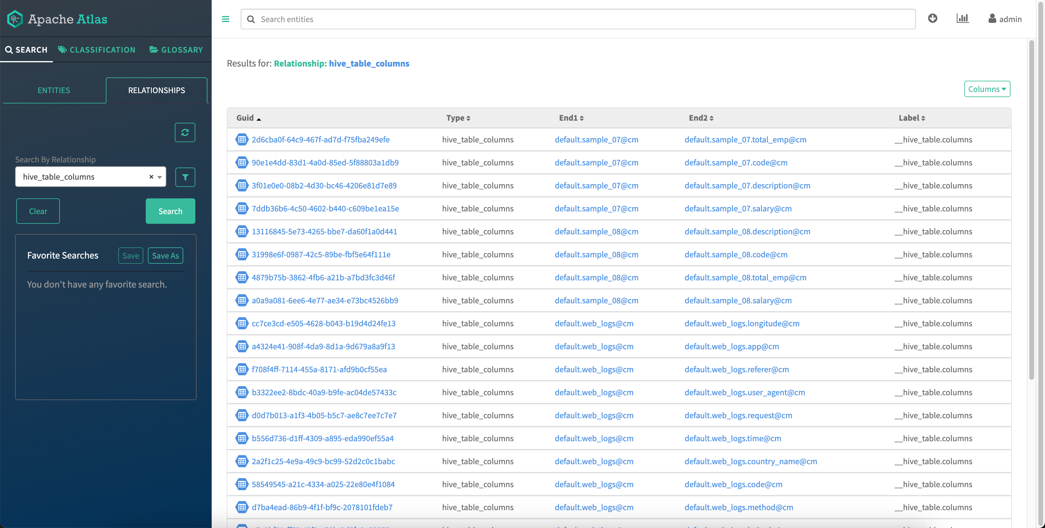

The list of entities with the type hive_table_columns contains additional information about the connected entities.
You can apply filters by certain relationships types to refine your search.
By clicking on each search result, you can navigate to the details page to view additional details and pertinent information.
In the example image, end 1 and end 2 are the entities with which the relationship is created.
