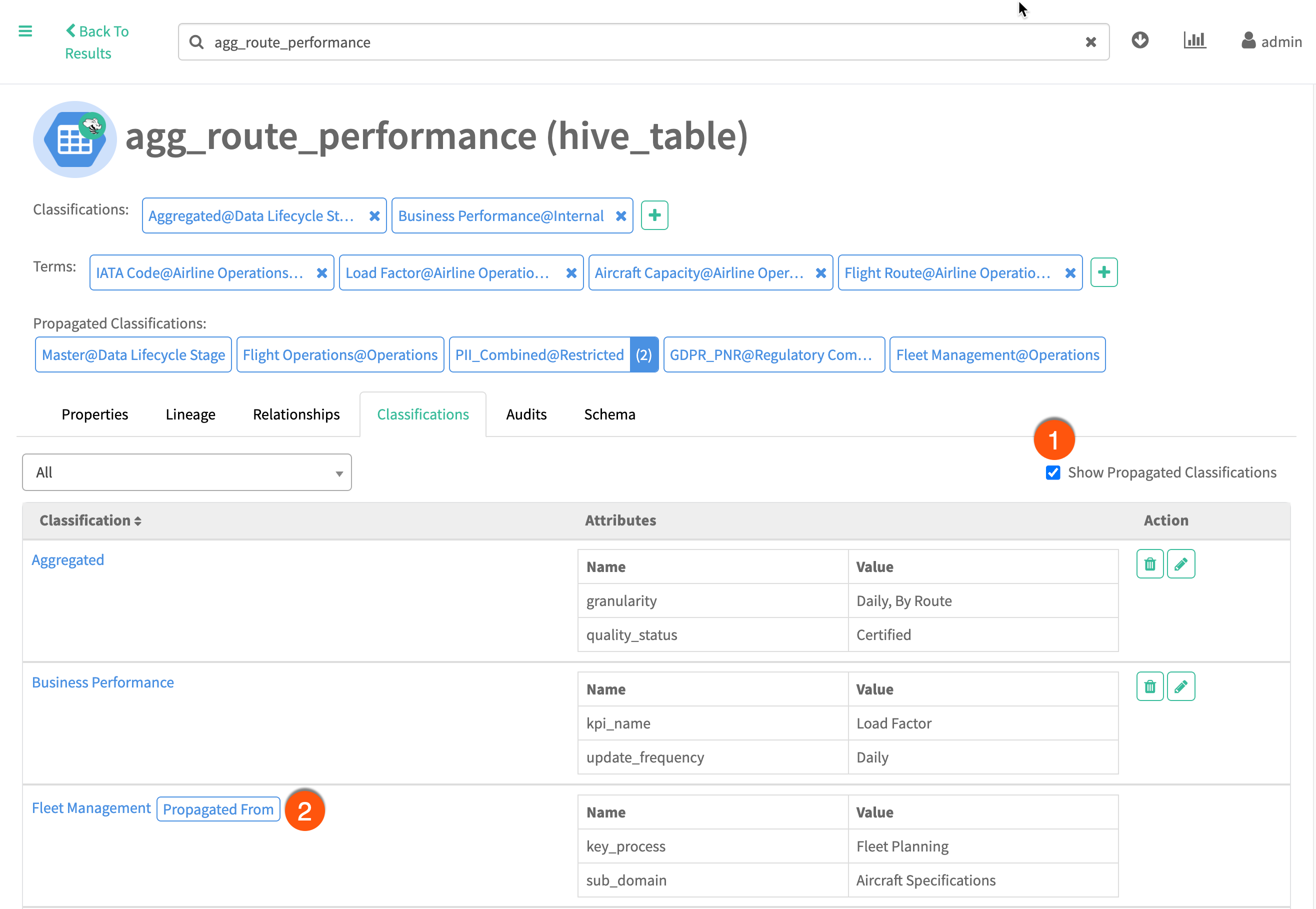

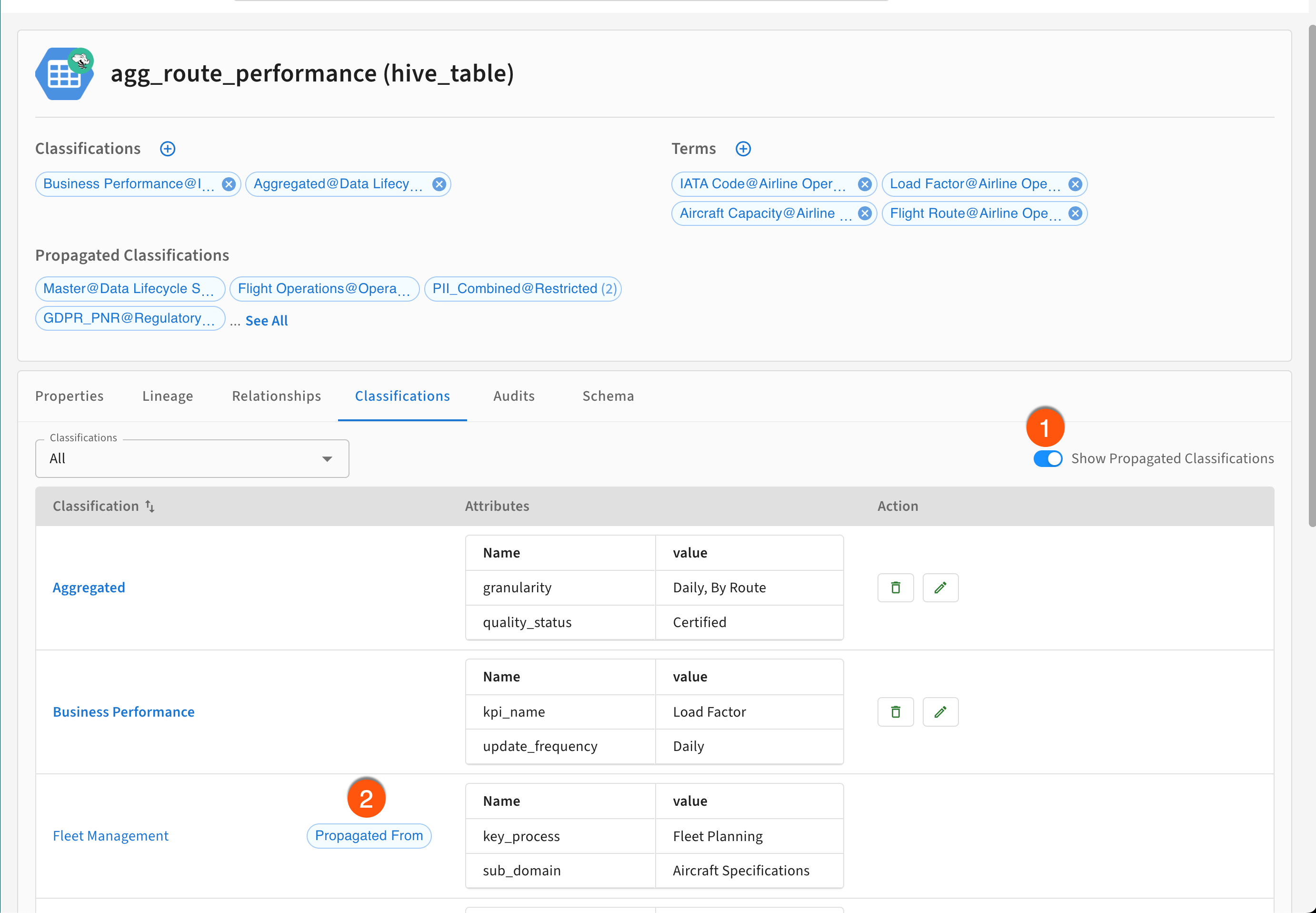

Viewing propagated classifications
When you look at the classifications assign to an entity, you can see which classifications where originally assigned to this entity and which were propagated here through lineage. From the Classifications tab, you can do the following:
- Show or hide propagated classifications (Show Propagated Classifications button)
- Navigate to the original entity where a classification was assigned (Propagated From button)
Navigate to the source of the classification:

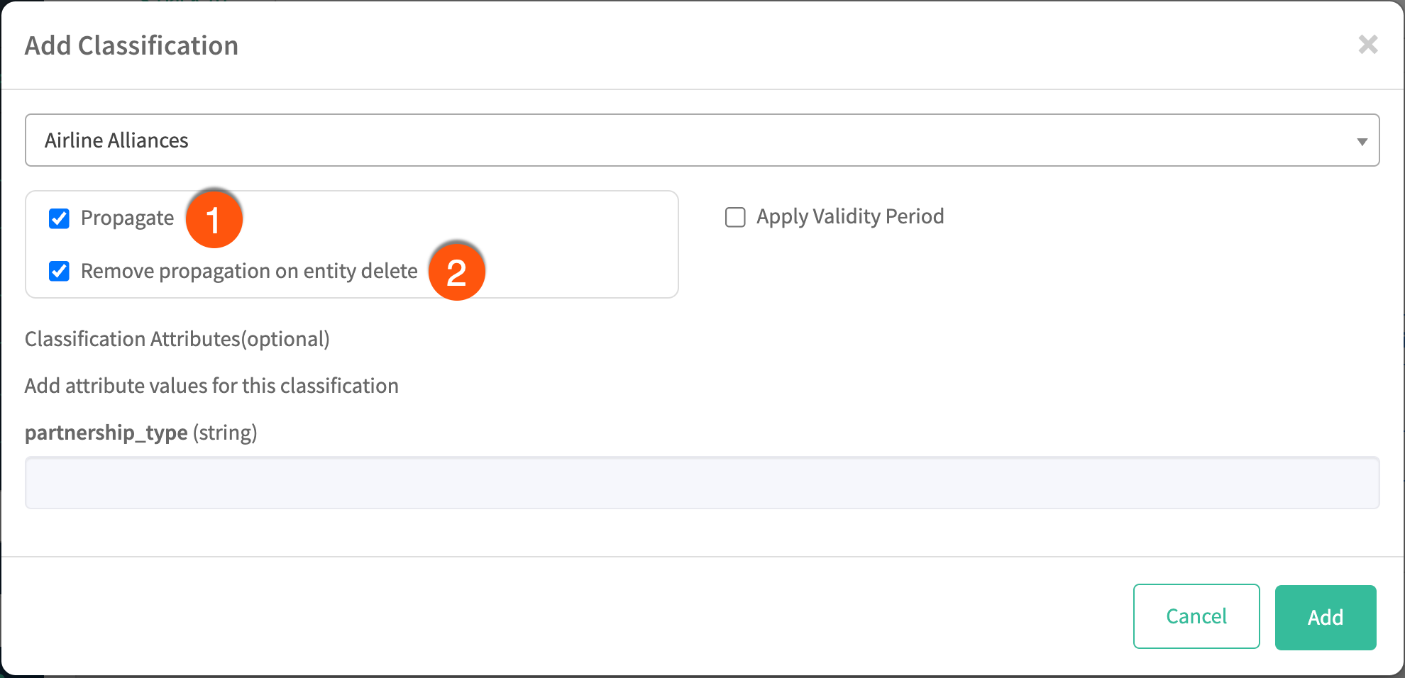

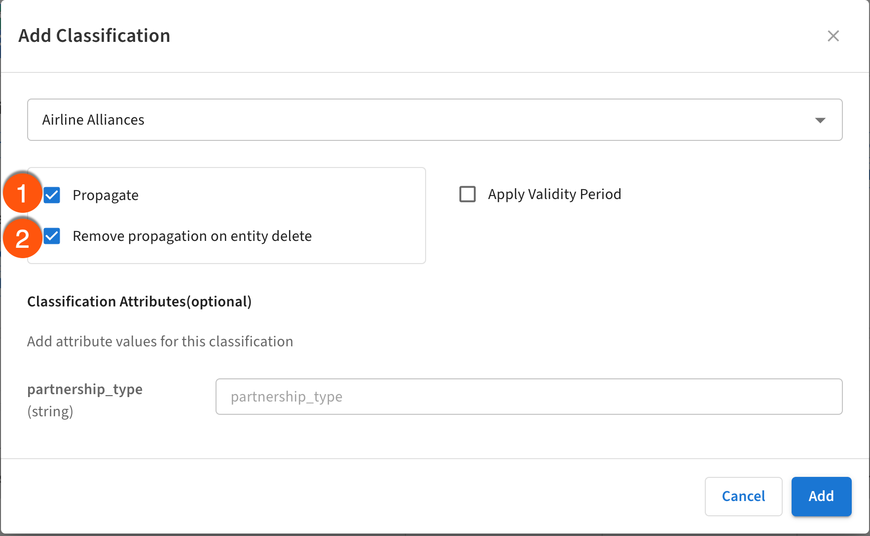

You can set propagation for a classification when you create the classification or in the lineage for an entity where the classification is assigned:
- Set propagation at the time when the classification is associated with an entity or term.

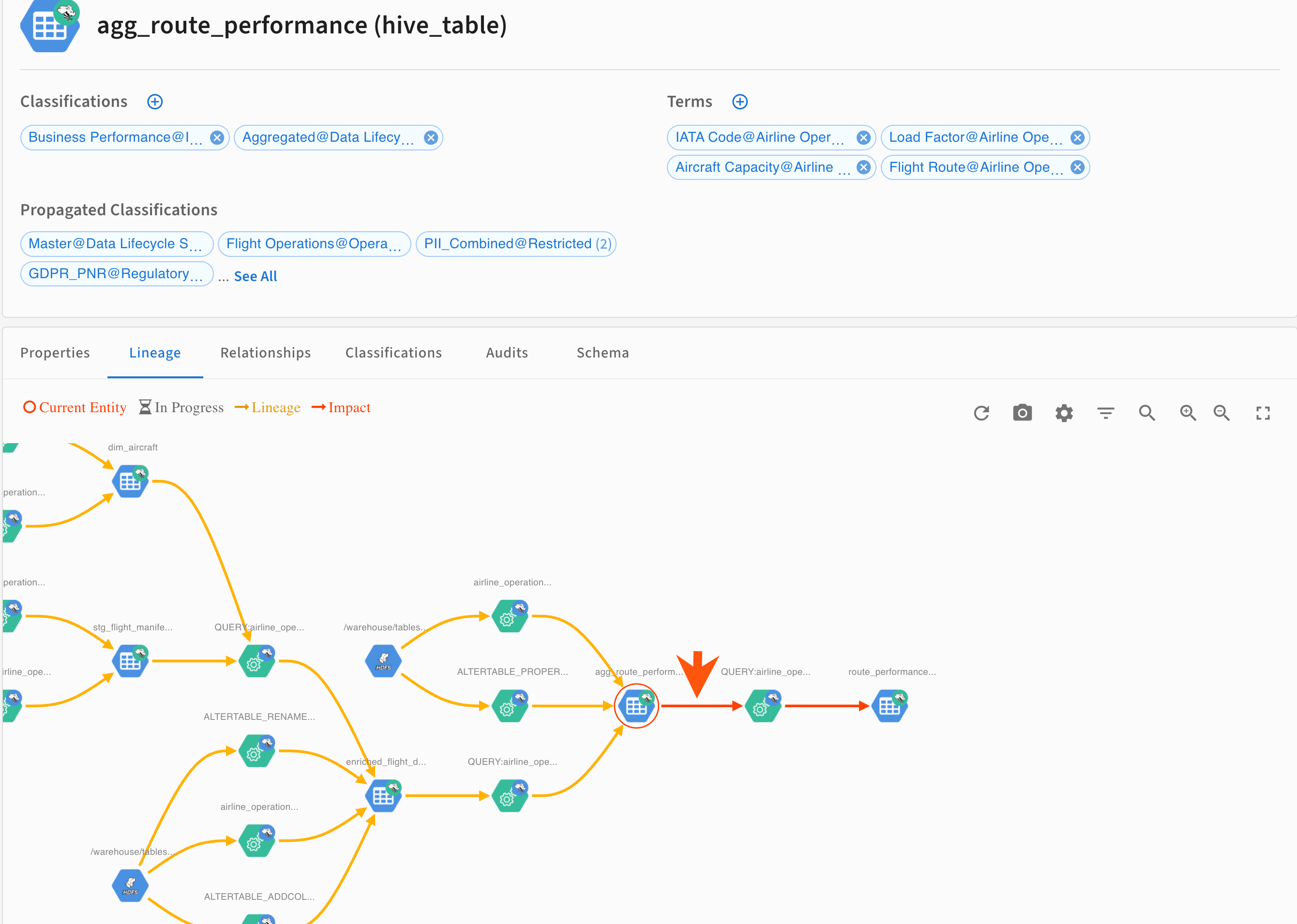

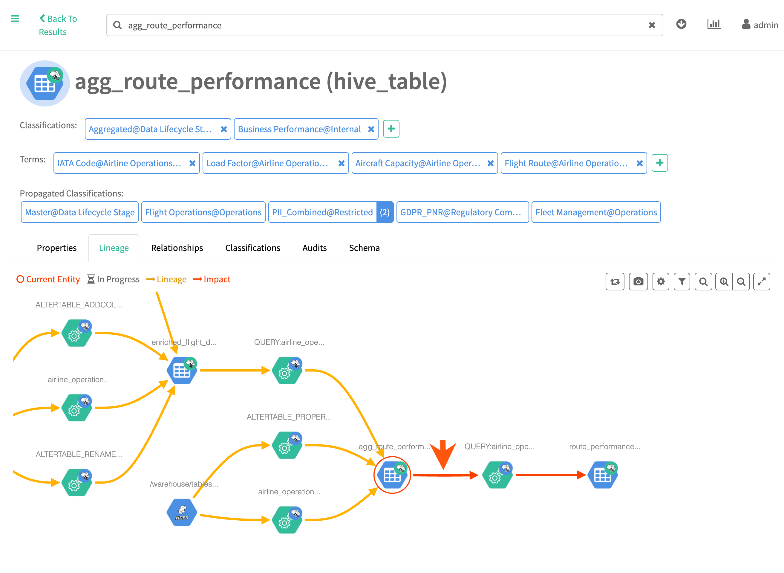

- Set propagation at a specific point in the lineage:

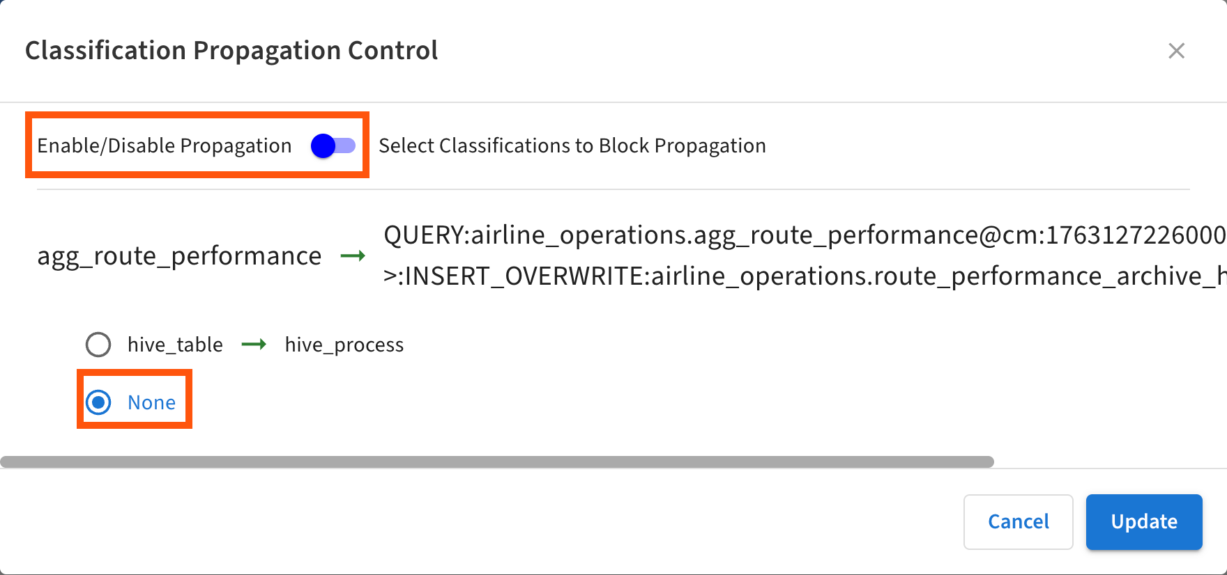

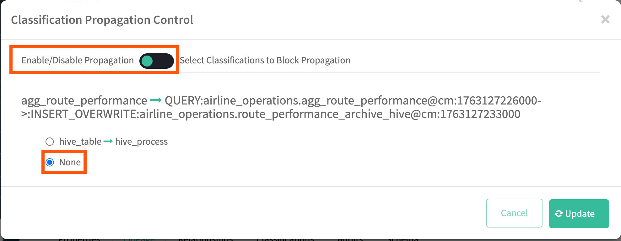

You can control classification propagation by click on lineage segment:

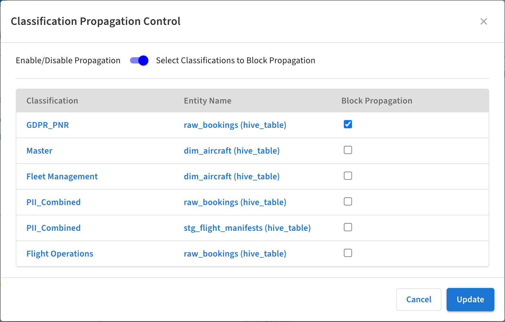

You can turn off the propagation at this point in the lineage. Classifications assigned to the entity will not propagate downstream.

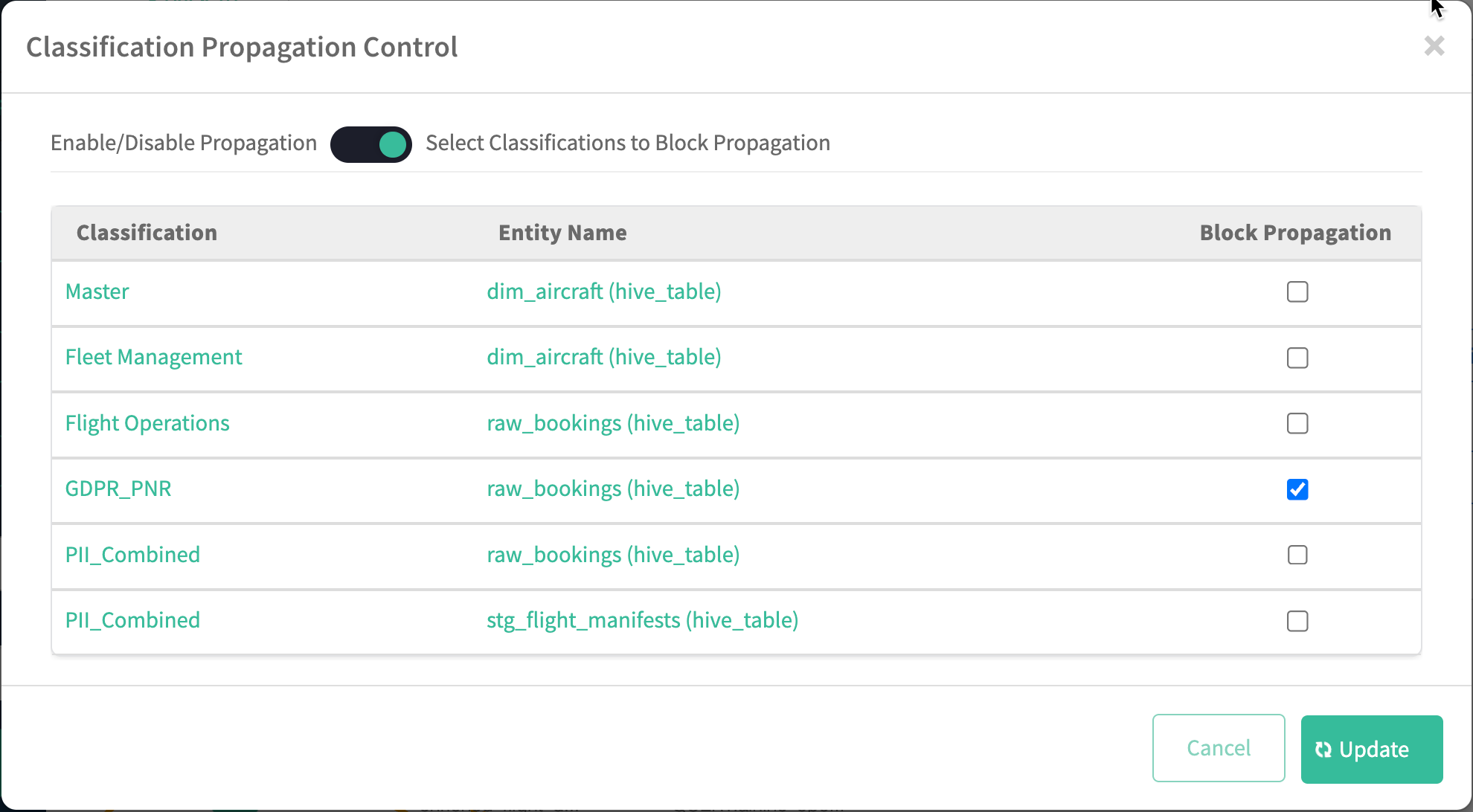

You can also block specific classifications' propagation downstream in the lineage:
