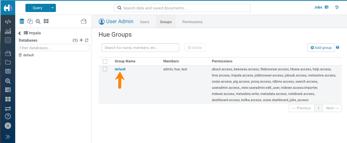

  5. On the User Admin page, click the Groups tab.
  6. On the Hue Groups page, in the Group Name column, click the default group.

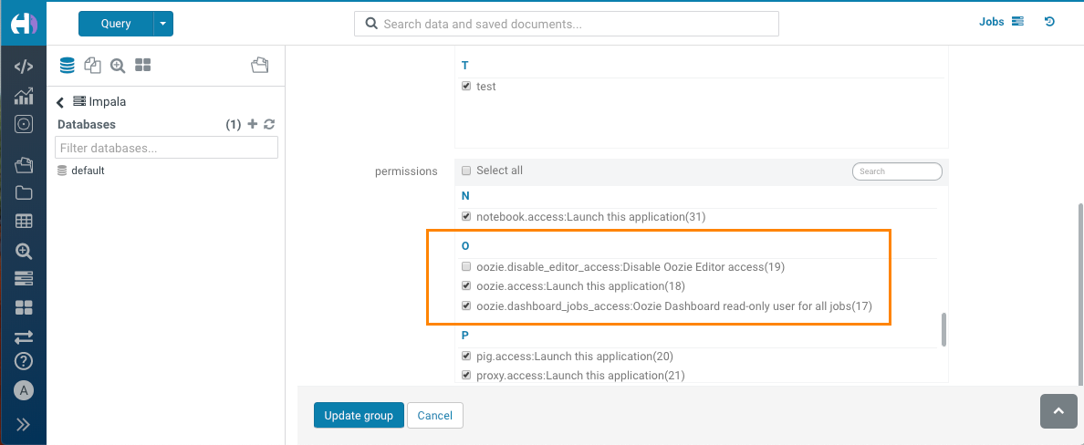

  7. On the Hue Groups - Edit group page, scroll down to locate the list of permissions and then scroll further to locate the Oozie permissions:
    Groups property in UI Description
    oozie.disable_editor_access
    Disables access to the Oozie editor for the selected groups
    Default setting: Unchecked, which disables this permission.
    oozie.access
    Enables access to the Oozie editor in Hue.
    Default setting: Checked, which enables access to the Oozie editor.
    oozie.dashboard_jobs_access
    Enables read-only access for all jobs in the Oozie dashboard.
    Default setting: Check, which enables this permission.
  8. Check or uncheck the permissions as needed and then click Update group to save the permission change.
