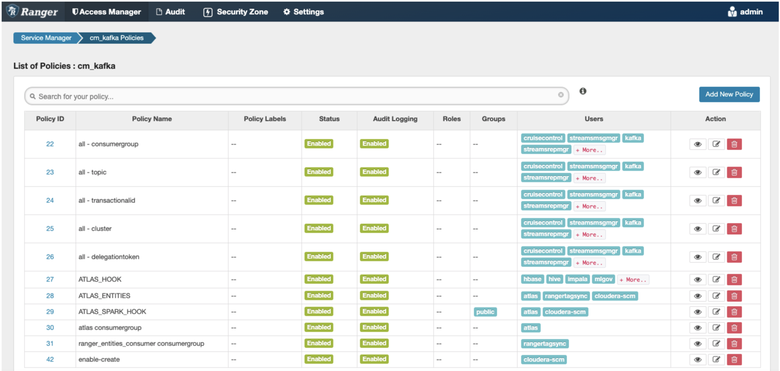

  4. Click cm_kafka in the Ranger service UI.
    The List of Policies page appears.
  5. Click Add New Policy.

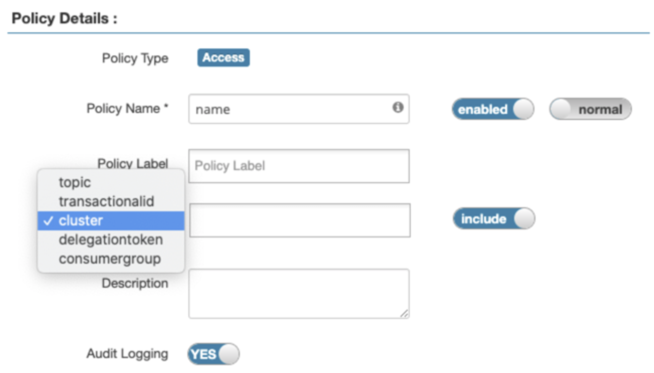

    The Policy Details page appears.

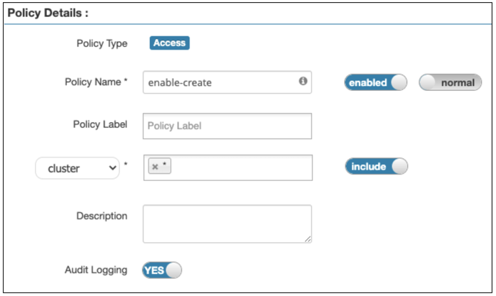

  6. Add a policy name and select cluster from the dropdown.
  7. Type * in the field beside cluster, and select the * from the values that appear.
