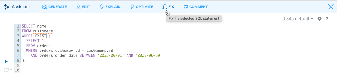

  2. Insert a SQL query in the Data Explorer editor that you would like to fix.
  3. Click Assistant on the Data Explorer (Hue) SQL editor:
    Screenshot showing how to launch the SQL AI Assistant from the Data Explorer web interface.
  4. Click FIX.

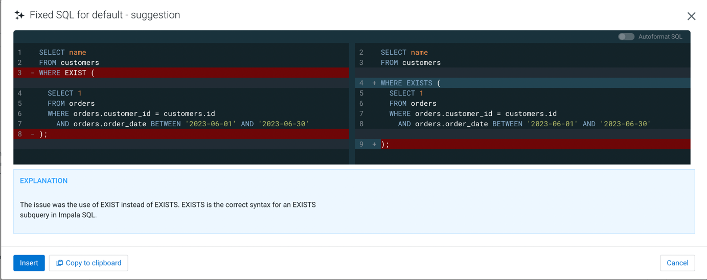

    Data Explorer displays the original and the fixed SQL query in a side-by-side comparison.
    Screenshot showing the original and the fixed SQL query generated using SQL AI Assistant in Hue along with an explanation.
    Click Insert to insert the fixed query in the Data Explorer editor and run it.
