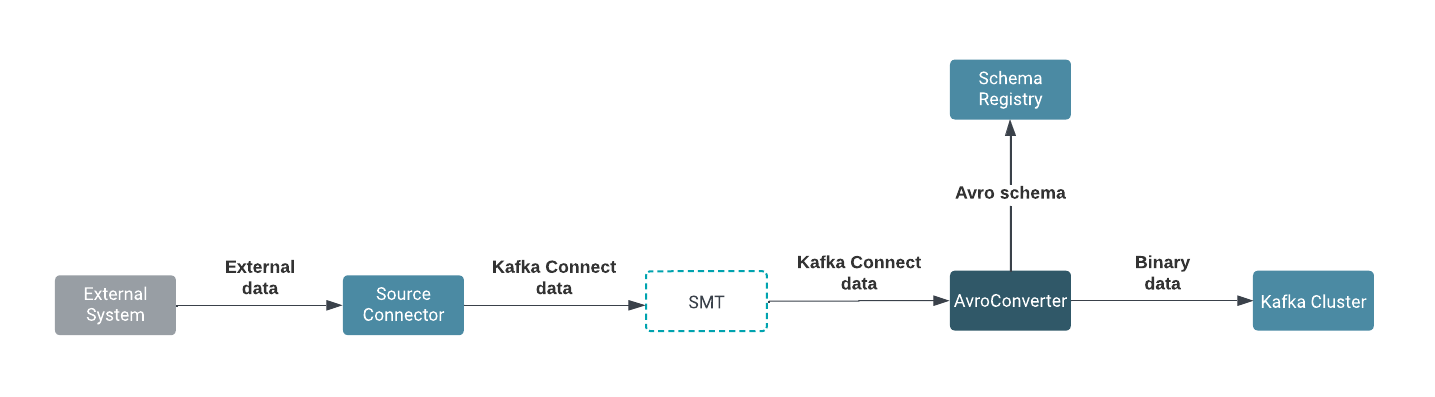

When using the AvroConverter with a Kafka Connect source connector, the source connector fetches the data from an external system. The fetched data is converted into Kafka Connect internal data format. If Single Message Transforms (SMT) are configured, the messages are converted based on the SMT conditions as well. If the AvroConverter is enabled, the messages are converted from the internal data format to Avro. At this step, the AvroConverter automatically also creates a new schema version in Schema Registry for the Avro data, if the schema has not been already created. In case the schema already exists in Schema Registry, schema creation is skipped and the existing ID will be assigned to the payload during the serialization. The converted data in Avro is written to the Kafka cluster with its corresponding schema ID from Schema Registry.
The following illustration shows the steps how AvroConverter works with a Kafka Connect source connector:

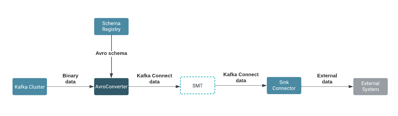

When using the AvroConverter with a Kafka Connect sink connector, the data is fetched from the Kafka cluster, which includes its schema ID from Schema Registry. The AvroConverver extracts the schema ID and gets the corresponding schema from Schema Registry. The data is converted from Avro format to the Kafka Connect internal data format. If SMT are configured, the messages are converted based on the SMT conditions as well. The converted data is written by the Kafka Connect sink connector to the external system.
The following illustration shows the steps how AvroConverter works with a Kafka Connect sink connector:
